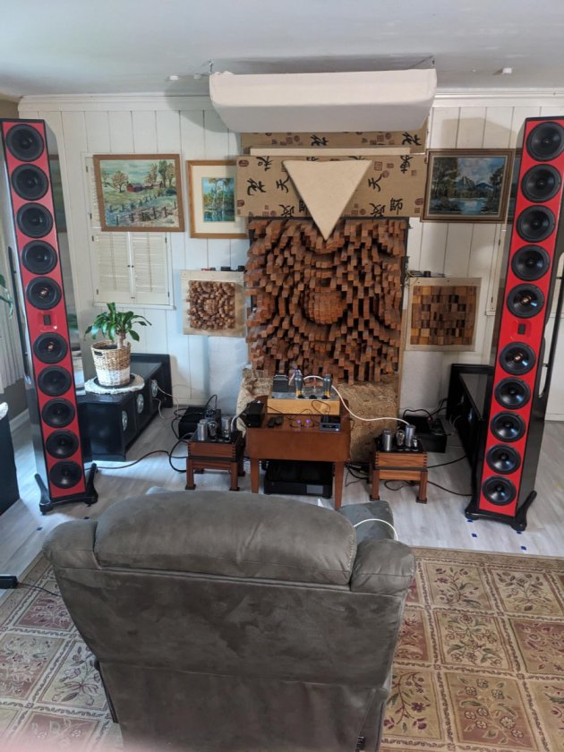

Hi Rock Ball,  I studied your build before I built mine 2 or 3 years after yours.  I had been thinking about trying my Triples laying down for a few days.  I don't get on the internet as much as I used to, becasue I juat listen to music when I am free.  But, last night I saw what you did and I did it today.  Despite the looks of it npw, I will leave them like this as long as I can get away with it :D  She is sitting beside me right now, and so far so good. :?
BenjaminWebber
Re: Dr Tom’s NX-Tremes
« Reply #16 on: 14 Jan 2026, 04:13 pm »
     I have mine standing up again.  I an old man trying to learn REW, so the following is based on my ears only.  I have lived in this house for about 30 years, using the living room to listen to music, through several different pairs of speakers over the years.  The bass has always sounded lumpy to me except with my first pair of diy speakers.  That is because they didn't have any bass lol.
     Around Christmas time my son downloaded an AI app on my phone called Perplexity.  It has turned out to not be perfect, but is amazingly powerful, especially when you "engage it in conversation."  It had never occured to me to have my seat or speakers off center in my 18' x 16' x 8' room.  However, when I told it that there is an 5'W by 6.5'H achrway opening into the rest of the house on the side of my right ear, it sugested that I move both my seat and my speakers about 1.5ft away from the acrchway and listen off center.  Boy did it work!!!  My son said Perplexity costs about $10/yr.  He set it up so that it will shut off after the trial period, rather than start charging me.  Perhaps this can help someone out there who does not happen to have a perfectly rectanguar room.
Sincerely,
Benjamin
BenjaminWebber
« Reply #17 on: 22 Jan 2026, 07:11 pm »
It pays to experient!  My ears are more happy than ever.  I wish I could verify with REW, but so far I am still too computer Illiterate.  I now have my right NX-T shifted 17 inches farther from the sidewall than the left one to compenste for the 5' x 6.5' opening to the rest of the house on the right side of my right ear.  My seat is also shifted 10" left (away from the opening)
I have both Triples laying down, but not horizantal.  They are each parellel to the side walls.  The center of the H-Frames are on the same line as each NX-T, fireing into their sidewall.  I "fixed" the right shifted image by pushing the right speaker a bit closer to the back wall than the left one.  I really like the bass now.
