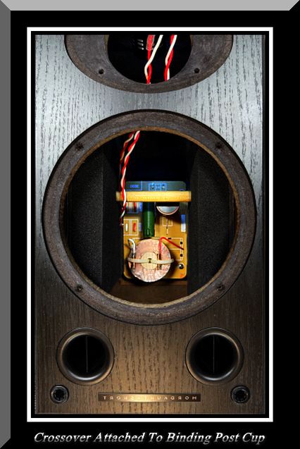

After watching Danny's upgrade on another Mordaunt Short model, I was motivated to upgrade mine.
I'm matching the part values on the stock crossover with higher grade components. Since I own 2 pairs, my first objective is to upgrade one pair first. Eventually I'll do a true A-B comparison, determining how much the upgrades improved the speakers.
Removal of the drivers, binding post cup, I noticed the crossover is literally attached to the back of the binding post cup. The Carnival 2’s have a first order crossover. This basic crossover consist of only three components. A 3.3 ohm 7-watt sand cast resistor, a 3.9 uF 250 volt polypropylene capacitor, lastly an iron core inductor. The crossover is only 3 ¼” x 5 ½” in size approximately.
