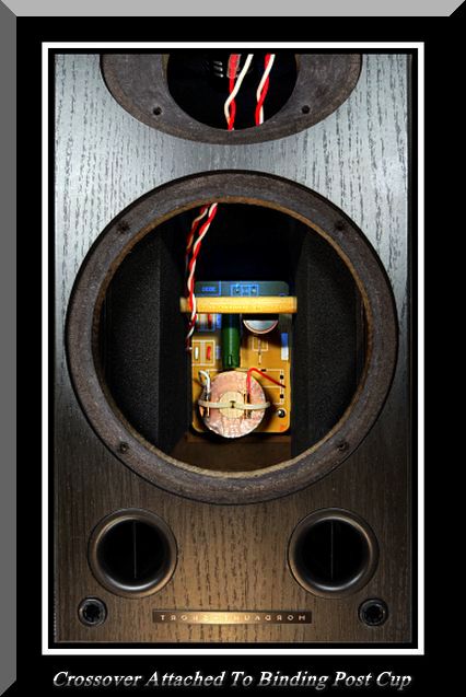

After watching Danny upgrade another Mordaunt Short model, I was motivated to upgrade mine.
I'm matching the part values on the stock crossover with higher grade components. Since I own 2 pairs, my first objective is to upgrade one pair first. Eventually I'll do a true A-B comparison, determining how much the upgrades improved the speakers.
Removal of the drivers, binding post cup, I noticed the crossover is literally attached to the back of the binding post cup. The Carnival 2’s have a first order crossover. This basic crossover consist of only three components. A 3.3 ohm 7-watt sand cast resistor, a 3.9 uF 250 volt polypropylene capacitor, lastly an iron core inductor. The crossover is only 3 ¼” x 5 ½” in size approximately.

Upgraded a very simple 1st order crossover. I thought about building from scratch a point to point crossover board, however, with existing crossover being such a basic layout, I made the decision to use the existing circuit board. I did add sorbothane under both the Mundorf copper foil inductor and the Dueland capacitor. All is very tauntly mounted. I have also rubber mounted the crossover board, which is mounted on the back side of the binding post terminal cup. It certainly can't hurt to apply sorbothane to possible reduce microphonics internally within the cabinet. I make no claim it will, perhaps it will? Notice how big that air core resistor is, it's literally twice the size of the stock sandcast resistor.
These tiny crossovers are fun to tinker with. Simplicity at it's best!  :thumb:
Unfortunately, I have a long burn in time with these Mundorf copper foil inductors. Between 100 to as much as 250 hours!
One note, prior to adding the Mundorf's inductors to the speakers crossover, I've noticed the speakers themselves are very user friendly with different accociated amplifiers. Since I have multiple amps, from tube amps, class AB solid state amps, even a modified Class D amp, it gives me a good sense of how diverse they really are.
« Last Edit: 7 Jan 2026, 10:54 pm by NXSTUDIO-DRUMMER »

Mordaunt Short - Stock circuit board retro-fitted with new upgraded Dueland capacitor, Mundorf copper foil inductor and Dayton 1% tolerance air core resistor. 8N OCC copper teflon coated wiring as well. Photo example of the crossover attached to back of terminal cup.
The 5 1/2" driver barely overlaps the NoRez about 3/8" when installed. The backside of driver shield housing area, in the past had a little ring when plucked with my finger. Non-issue now, since it fits between NoRez now. Even though the internal quarters of the cabinet are tight, there's still  enough space though. The driver can still function, and not be choked by the NoRez, which could possibly disable it to move air mass within cabinet.
Overall, This is a very easy upgrade project mod. :thumb:
