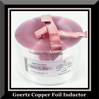

Upgraded a very simple 1st order crossover. I thought about building from scratch a point to point crossover board, however, with existing crossover being such a basic layout, I made the decision to use the existing circuit board. I did add sorbothane under both the Mundorf copper foil inductor and the Dueland capacitor. All is very tauntly mounted. I have also rubber mounted the crossover board, which is mounted on the back side of the binding post terminal cup. It certainly can't hurt to apply sorbothane to possible reduce microphonics internally within the cabinet. I make no claim it will, perhaps it will? Notice how big that air core resistor is, it's literally twice the size of the stock sandcast resistor.
These tiny crossovers are fun to tinker with. Simplicity at it's best!  :thumb:
Unfortunately, I have a long burn in time with these Mundorf copper foil inductors. Between 100 to as much as 250 hours!
One note, prior to adding the Mundorf's inductors to the speakers crossover, I've noticed the speakers themselves are very user friendly with different accociated amplifiers. Since I have multiple amps, from tube amps, class AB solid state amps, even a modified Class D amp, it gives me a good sense of how diverse they really are.
« Last Edit: 7 Jan 2026, 10:54 pm by NXSTUDIO-DRUMMER »
