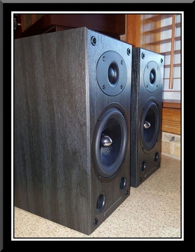

Mordaunt Short Carnival 2 Upgrade Project
Note: These are the last iteration model release. Older models look very different.
Sold Retail New for $249.00 pair.
Specifications:
    • Drive Units: 1 x 5.5" Woven Composite Cone, 1 x 25mm Soft Dome
    • Sensitivity: 90dB
    • Frequency Response: 55 Hz - 20 kHz
    • Crossover frequency 3.5 KHz
    • Impedance: 4 - 8 Ohms
    • Recommended Amplifier Power: 15-100 watts
    • Magnetic Shielding: Yes
    • Dimensions: 12 9/16” H x 6 ½” W x 8 5/8” D
    • Weight: 4.75 kg each / Approx. 10 ½ lb.
    • 1" Soft Dome Tweeters & 5-1/2" Drivers measure with LCR meter at 8ohms. For those who may be interested in tweaking resistor values,
       between the 3.5hz crossover point of the 1st order crossover network.

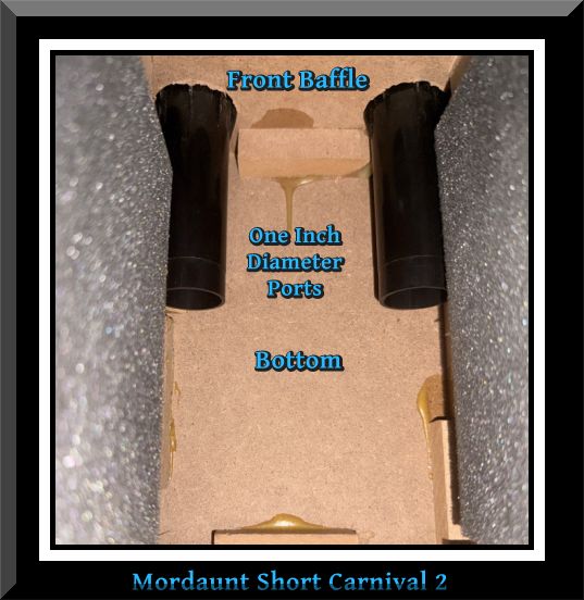

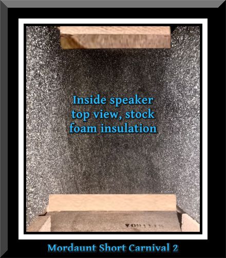

NoRez, & cross-bracing applied, really makes the cabinet significantly inert.
Positioned NoRez 1" above the ports, enabling them to function, based on the manufacturer design. This photos was taken before I went back and installed a 3/4" dowel support between the front baffle and the rear cabinet.
The little 5/8" Dia. dowel rod going between the cabinet sidewalls really makes a difference with how inert the cabinet is now. The MS's are actually more inert than my NX-Studio's with this additional Dowel added.

I'm actually in the middle of upgrading my second pair of Mordaunt Short 2's now.  One thing I just completed, that I didn't do on the first pair, was providing a 3/16" roundover on the 5 1/2" backside hole on the front baffle. I had hoped I could go larger, but the sidewalls are so close, I didn't have room to do it. It's still better than a sharpe edge, which causes diffraction. I also went with a 3/4" dia. crossbrace too. Not that the 5/8" dia. didn't work well. I just used what I had laying around.
Finished upgrading my second pair of Mordaunt Short Carnival 2 speakers. The project came out excellent, now I'm starting the burn in process on all the upgraded crossover parts.

Next Tweak
These new rubber plugs give me the option of ported or sealed cabinet.
Sealed conversion provides a much smoother transition between sub.
