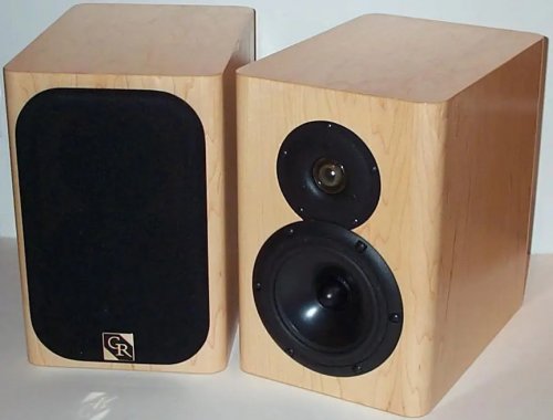

As I recall Danny explaining it, this speaker below was important.  The A/V1.  A simple, accurate 2 way.  Danny's 5" 2-way speakers are among his most accurate, if not the most accurate.
So, if you measured that A/V1 like normal, you'd have a response.
Then, what if we put that A/V1 into a room big enough for the 20/21 to open up properly.  We place that A/V1 in a certain spot... in fact, the same spot where you will place the 20/21.
Then, we take a ROOM measurement of the A/V1.  We are measuring a known, accurate response speaker in a room that will have a different response.
Now, we can't measure the 20/21 like a regular speaker; however, we can put it in the same spot, in the same room as the A/V1 we just measured.
We have a benchmark in the A/V1 response to go for with the 20/21.
Now, with "Network Version XXX", what is the ROOM response of the 20/21?  How does it compare to a KNOWN accurate speaker in that SAME ROOM.
And then... "If it sounds good, it IS good." And you get to that point.
