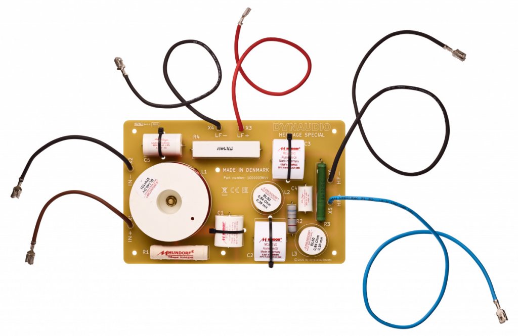

I went ahead and reached out to Tony Gee for any ideas about the large caps, and what cap he thought would be best for the 56uF value "sound quality" cap.  Tony mentioned the Jantzen Audio Cross Caps and the Mundorf MCap EVO (less economical, but compact and good) for the big cap values needed.
For the 56uF "sound quality" woofer spot, he likes the Duelund CAST-PP - not surprising.  I know Tony likes Duelund and I do too.  I may still reach out to Frederik directly and ask if there's any way he can "work in" some 56uF when the machine is setup to be able to make that value.  Who knows. Well, we'll see.
Mundorf can work... there connecting this dot.  Dynaudio uses all Mundorf MCap EVO Oil in their Dynaudio Heritage Special - as speaker I bet I'd LOVE.  Tony Gee also thinks very high of those caps.
PLUS, they are available in large sizes to eliminate the 500uF electrolytic, and it also comes in a 56uF - so no jumping thru hoops to make that value.
Probably go ahead with Mundorf resistors as well. Then, bypass all caps with copper foil bypass caps.  I think that could be a GREAT crossover.
There are so many ways to do it with great parts, and the Sonicaps with copper foil could be plenty good - as it is!
If I didn't like speakers with Danny's hands on them, I would probably have a pair of Dynaudio Heritage Special - and still may yet.  I think they are doing it right and I notice stuff like that, I guess.

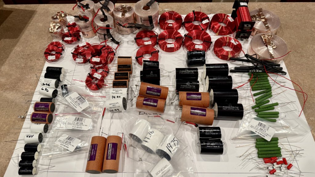

Custom cap shipment.
8)
jmimac351
  • Posts: 772
  • Chief Instructor ChinTrackDays
Re: Epiphany Audio 20/21 Line Arrays - Danny Richie Creation
« Reply #49 on: 29 Oct 2025, 03:04 am »
Caps showed up, and look great.  Reliable Capacitors / REL-CAP.  The 3x185uF values will replace the 500uF electrolytic which was bypassed with a 56uF poly cap.  It's a bit of overkill given where it is in the network, but I'm glad I'm doing it.
I have all values for the crossover in REL-CAP, so I can use these and / or put Sonicap on the Tweeter.
Although... the black cap in the line are a Metallized Copper Poly cap, in the tweeter sizes.  Those were sent to try.
I am also getting Copper Foil Film caps for the Tweeter from REL-CAP.  Those will be a little while.  Pricing appears to be excellent.

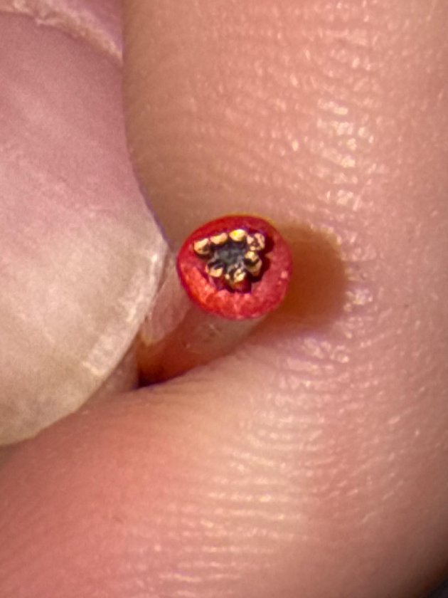

As for "wire"... I made some friends at Shunyata Research over the summer.  They don't sell "bulk wire" (at least not advertised), so I did something crazy... I shared what I was doing and asked them if they had any ideas, would sell some to me.   I got to thinking about "current" and all of those drivers, and even considered going with a larger gauge.  Chris at Shunyata thought the geometry of their 16ga VTX wire would be better than going with a larger gauge of "normal wire", and they could not have been more helpful.
So, I now have 140' of 16ga Shunyata Research VTX wire.  It's amazing what happens when you ask nice people for help!
And, I also have a pile of Danny's 16ga solid core wire, which I've never had a problem with and think sounds great as well.

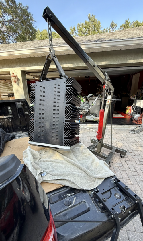

It's going to be a lot of fun putting them together.  I hope you have a few strong friends to help you move them around.  If I was near by I would lend you some help.
I bet you would Brandon, Thank You. 8)  They were a load for Danny and me just to turn up in the crates, as empty enclosures. Danny also has some "50 year old shoulders" he's dealing with, and I do too - if you know what I mean.  Danny's NX-Treme are very easy to slide around by comparison, but these will be a load.
All the more reason - as I'm not getting any younger... you've reminded me about casters.  Because my buddy has a pair of Alexia and I've seen how easy that makes things, a while back I dug into which casters Wilson uses, and I think I figured it out.  I thought I might as well use the ones I've seen work in person, in the same application / flooring.
The experience I had with my buddy's Alexia on casters helped with this idea too.  Yeah, they are big, but the footprint is not that big.  I've had Magnepan 3.7i and I think WIDTH is the bigger issue.  I will be able to roll these out into position, and tuck right back against the wall, over in a corner... wherever, if I'm playing with something else.  Slim and tall is fine, and looks even better with tall ceilings.

We have this network sorted for parts.  When it all gets here (next week?) I will plot out for spacing / board size with Frederick.
Frederick will build this network:
- Tweeter: REL-CAP PPCuT caps - Polypropylene and Copper Foil
- Tweeter: Alpha-Core/Goertz Copper Foil inductors
- Woofer: REL-CAP AudioCapX internally bypassed caps (large values in parallel to eliminate 500uF Electrolytic)
- Woofer: Alpha-Core/Goertz Copper Foil inductors (even in notch filter)
- Woofer: Duelund CAST-Graphite tinned copper resistors - paralleled / doubled for power handling
- Bypass: .1uF REL-CAP and / or Duelund CAST-PIO copper foil bypasses throughout
I also have parts for a second network.  I may play with this network on my own:
- Tweeter: Sonicap
- Tweeter: Air Core Inductors
- Woofer: JB JFX Cap on main sound quality spot
- Woofer: Electrolytic cap (500uF) / JB JFX 56uF in bypass on Electrolytic
- Woofer: Air Core / Iron Core inductors - iron core in notch filter
- Woofer: GR Research resistors
- Bypass: .1uF REL-CAP copper foil and / or Duelund CAST copper foil bypasses throughout
All wired with Shunyata Research 16ga VTX wire.

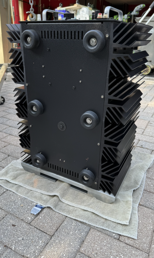

Also, you don't see this everyday so I figured I'd share about "heavy stuff" (and maybe sell stuff).  So, this is the strategy: "Tools are free."  "Tools don't cost money... tools make and save money".  NOTE: Please don't tell me I am wrong because it is much more fun buying tools.  Remember that when buying new tools, no prudent financial decisions need apply.  Matter of fact, I can rationalize that for speakers, amps, etc. too.  It's healthcare - and I am serious about that too.
There was this sight when I brought the Pass Labs XA200.5 home after I traded my Ayre Acoustics MX-R Twenty monos for them, straight up.
They weigh 159lbs each (not 160, only 159).
I don't think I will have the "cherry picker" inside the living room; however, 26 years ago I married a Saint who's favorite thing is for me to be spoiled and happy... so it could happen.  She would just roll her eyes and laugh.  :green:
And, SHE is the one telling me NOT to sell them... she must have a real bad audio problem, too.  :green:
These will be for sale very soon as I have found something that will fit this slot in the "drive anything" need, for an incredible deal.  It shows up tomorrow.
These are a very late production cycle build, and Kent at Pass can tell you about them.  "Industry accommodation" and I think they truly have very little use.  I got them from a friend in Sarasota who got them from the estate / dealer of the original owner.
These have to be as good as any example on the planet.  They are very, very special.  I just can't own every cool thing, as much as I'd like too.
