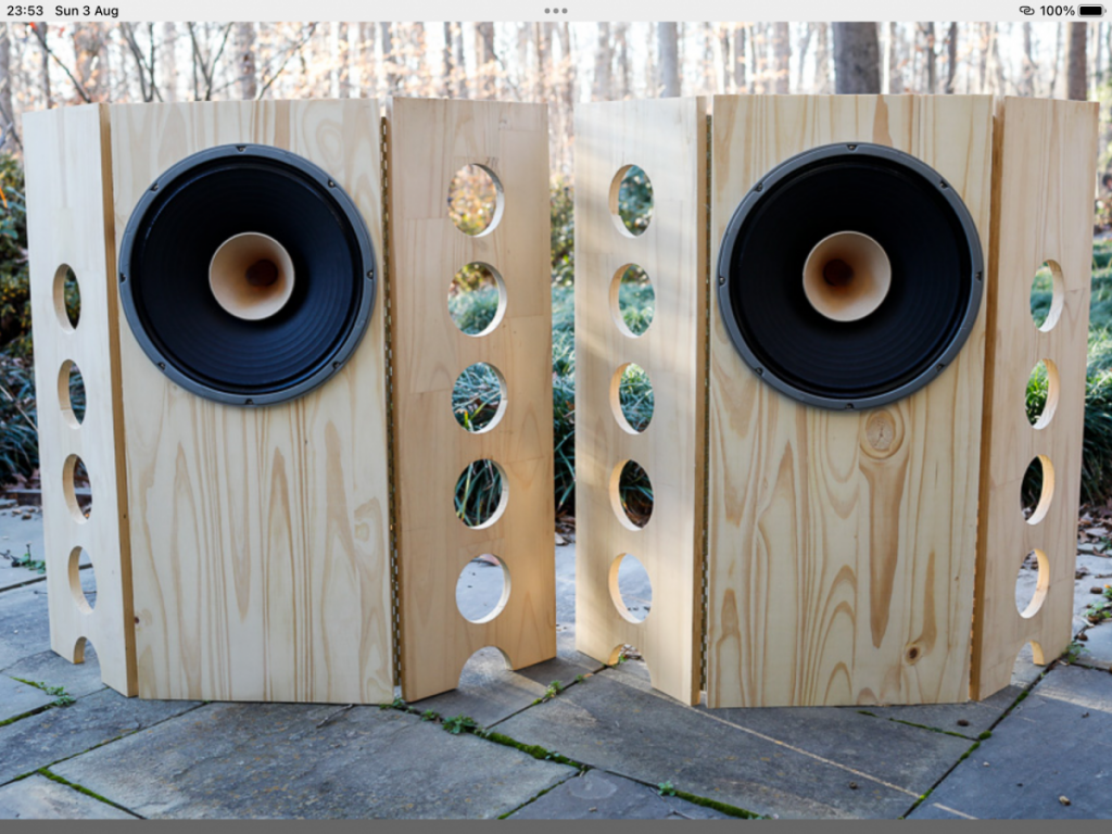

Check the Lii Audio F15 or F18 for a OB panel, they are your best option.
The F15 also have a BR BOX plan on the Lii Audio site.
The best sound quality you can get are crossoverless speakers, mainly in transparency and soundstage.

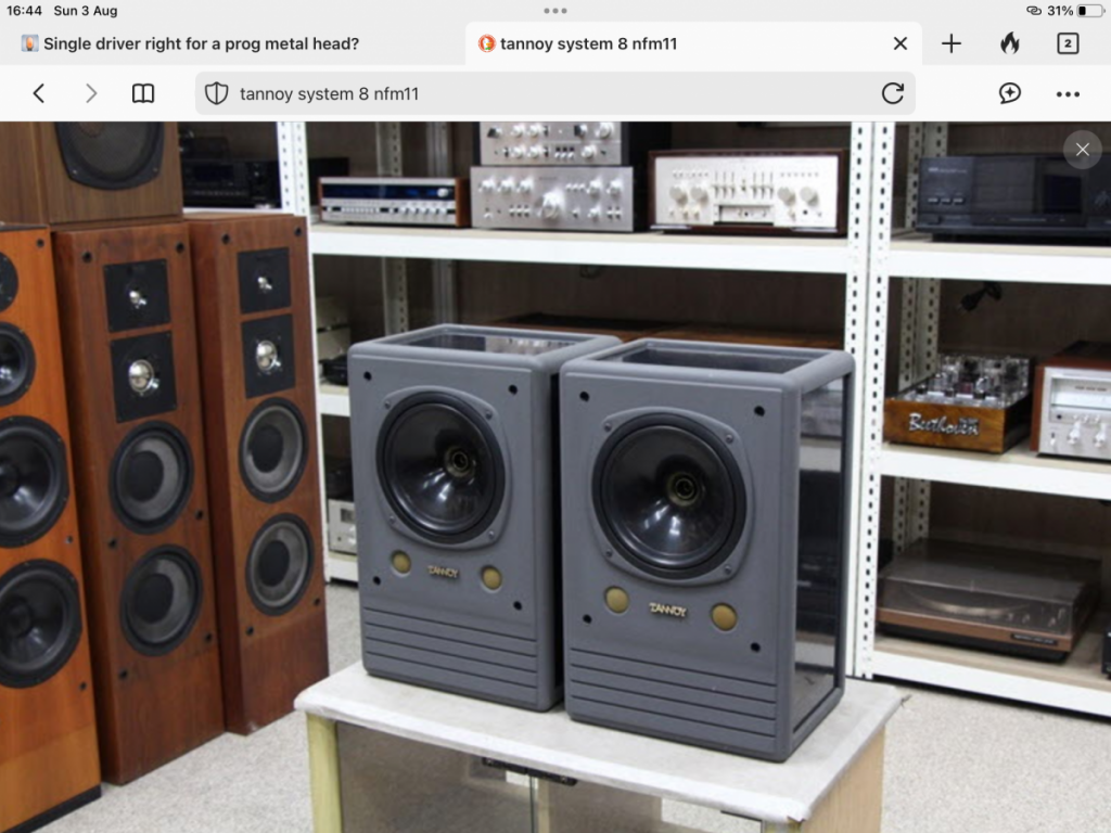

The Tannoy System 10 DMT mk2 is a great quality point-source unit for you. Slightly large though for what you want, at 56cm high.
But it will handle high-level transients with ease. Very popular hip-hop studio speaker.  The treble rolls off nicely for what you want. Very low distortion. Almost zero-fatigue.
Prices well under a grand.
They’ll crank Death Metal, Industrial Machinery BiPolar Suicide Jazz, or a Road-Resurfacing Sonic-Grudge Orchestra all day!  They’ll even play music!  Lol
The Tannoy System 8 NFM11 is a smaller,  but similar design driver, and definitely no slouch. Around $400-$500 (46cm high). That would do everything you want.
Both mk2 models will work well with a sub, and even give you good bass on their own, with clear lo-mid definition, polite but firm high-mids, with a sweet upper-end.
I use System 12 DMT mk1’s and often crank some Kings X through them, with no sub. They play me out of the room at 300W a side with full level.
Here’s the 8’s.  Honestly - they really are good.

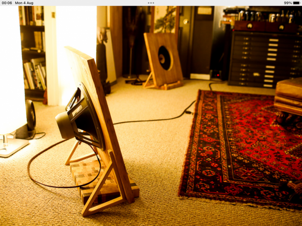

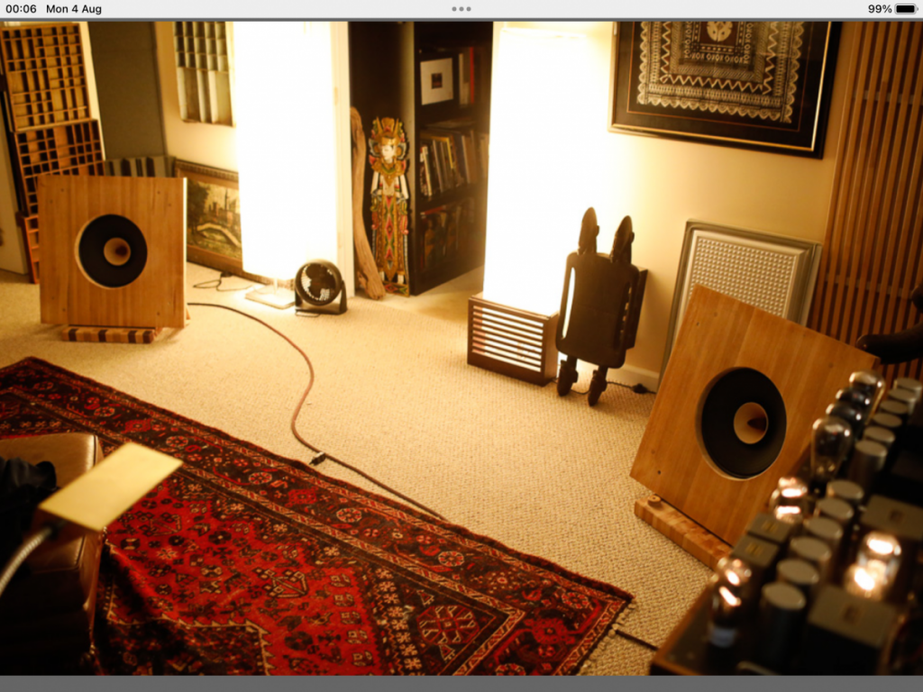

OP might wish to rethink. Any change can be difficult, and dragging ourselves away from preconceptions and subconcious bias cues can be very hard. But in this case it’s worth the effort, and you already obviously thought about it a little bit.  You asked about full-range in the right place, so here we all are - with all the info you could wish for, and the desire to help a fellow music-lover, with an interest in good, big sound.
 I used original K-Rok passive studio monitors on adjustable stands for many years, and they were great for recording/mixing at home. But when I upgraded from 6.5” to 12” drivers to move some real air, I thought about it for all of 5 seconds, then the single-post stands were given away to a charity shop. I started with solid concrete blocks, but now have retro Partington stands - on concrete.
The K-Rok’s look like toys to me now - and they are. I’m now moving big air. My mental bias has shifted completely, and I could not go back to a small 100W driver in a shoe-box - sitting on a ski-pole!
I like the smaller tilted baffles pictured. Easy to move those around if needed, but they’ll fill any 20’x30’ room with an airy presence, and good bass - with enough mid detail.
Show these pics to any woodworker/furniture-maker. He’ll order your wood of choice, and he’ll knock them up in a couple of hours.  A simple light stain and job done.  No real time or effort involved.  If you can’t be arsed, or are just plain lazy, then tell me now, and I’ll go and help someone else, whilst you look for Tannoy System 8 NFM2’s online..
Fuck me - you could bolt those Lii F15 speakers to a wooden toilet seat, just to get by, and use the lids as bases!
I would certainly agree with a quad of EL34’s for power, and pretty Chinese knockoff valve amps are around for less than $400, with $240 for smoother treble, delightfully-balanced Svetlana, proper St.Petersburg winged-C EL34’s - which have a big soundstage.  Single-ended valve amps are even cheaper, with just a pair of Svetlana’s to buy.  The Gemtune BL-02 is very popular, and you can pick one up easily for $350, often with valve upgrades.
Don’t see why you couldn’t kit out completely for $1200, including woodwork, and recoup some funds from selling the Arcam SA20, subs, your stands, and any other kit - as you won’t be going back.  You don’t have to change your musical tastes, but you will find yourself listening in a whole new way, as the depth and imaging opens right up.
