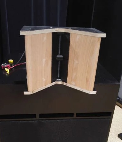

I plan on mounting mine naked on top of my Butcher Block baffles, which will support the weight. Mounted on a detached round aluminum disc, resting on a "cup" of more aluminum angle. That way I can experiment with toe-in of the AMT, not the entire baffle. The weight will then be an advantage in this case.

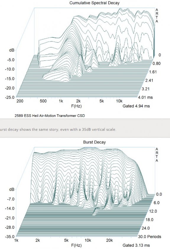

I don't recall seeing such extensive measurements of Heil AMT before, and these have VERY clean cumulative spectral decay and low distortion  :thumb:
I have a bunch of them and would love to find something like Altec 414 12" woofers (99dB sensitive) and place a double-stack Heil on top!

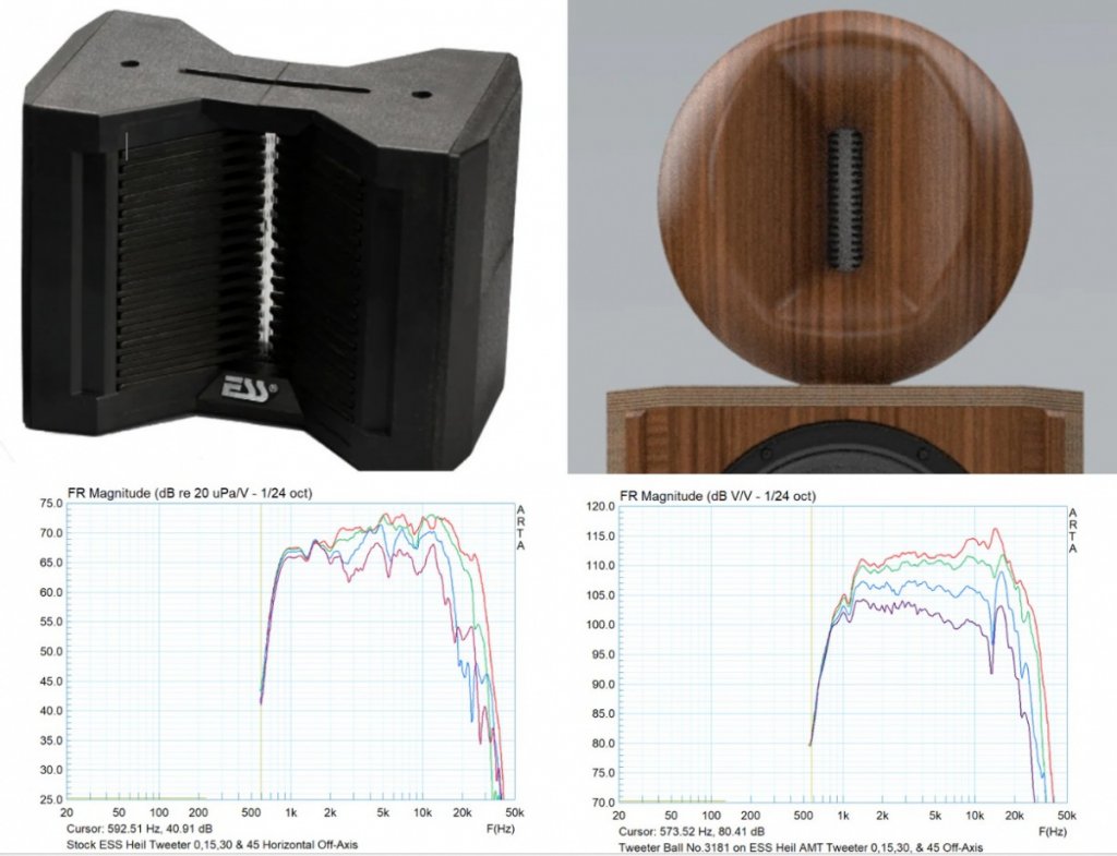

This posted recently on the Joseph Crowe website:
https://josephcrowe.com/blogs/news/tweeter-ball-no-3181-for-ess-heil-amt-tweeter
Looks like it was very labor intensive ( = expensive  :icon_lol: ) Nice looking though.

Looks nice and premium but labor and cost-intensive  :green:
It does smooth out the spectral decay, but stock Heil already has good CSD, and the downside is narrowed directivity with the ball.
