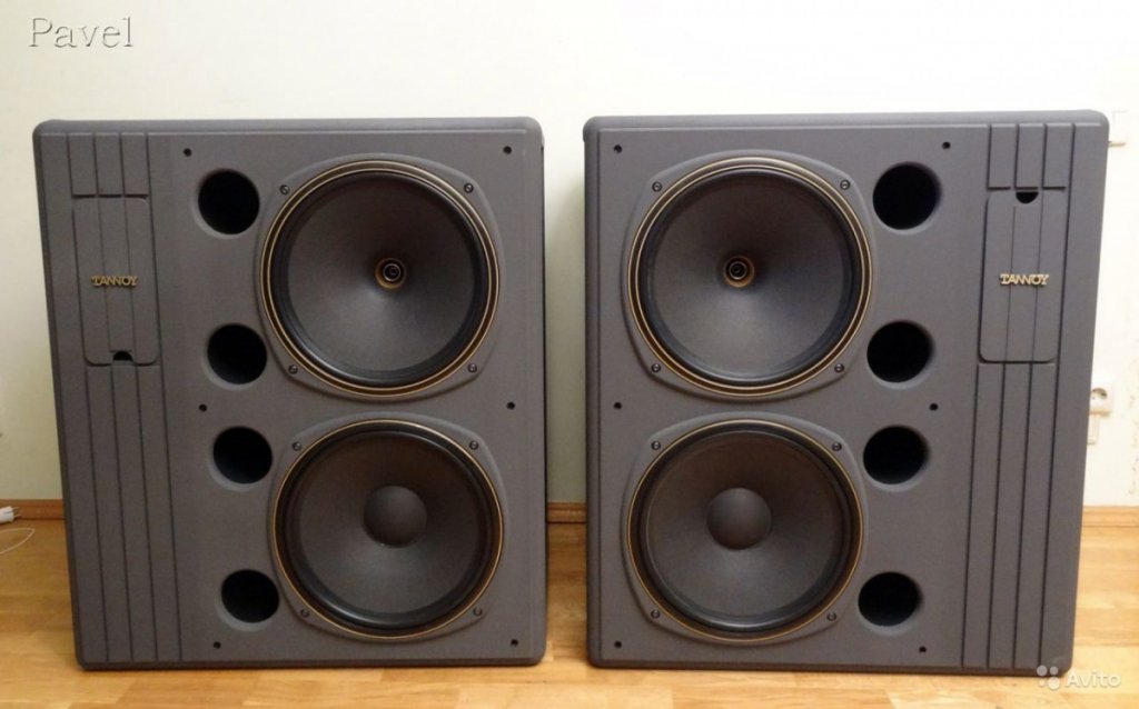

This is my current gear. Mk1 System 12 DMT’s.
A bit more manageable than the space-hogging 15’s in a small living room. I sit 7ft away, and the speakers are 6ft apart. The imaging is still huge!!

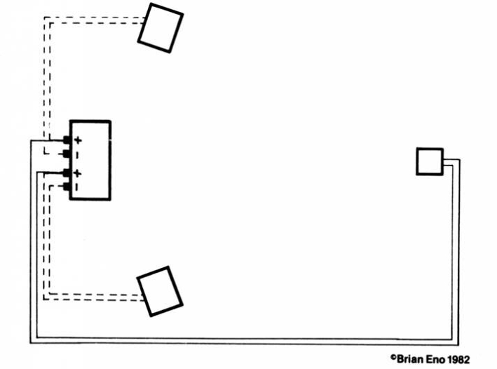

In the late 80’s I experimented with an Ambient setup at home.
A third cheap full-range speaker was positioned on the floor 6ft behind my chair. Pointing up at 45 degrees - connected to the red terminals of each amp channel.
I can’t describe the vastness of space this creates, but I’ve experienced Jimi Hendrix’s guitar on “If Six Was Nine” start in one corner of the room, 8ft behind the right speaker, and fly right through my head to the opposite corner 8ft behind me, and back again!  You can only imagine what the gyrational panning of  “Gypsy Eyes” sounds like.
I myself then produced a lot of my own ambient guitar music - utilising lots of panning to create that through the head thing.  But it was a trip I eventually snapped out of, as the amp got a bit hot!
 There are several Brian Eno recordings done in Ambient, that sound incredibly spacial, even in conventional stereo. I guess Daniel Lanois would be another contender.

This is the 1982 Brian Eno system mentioned above.
https://scannerdot.com/how-brian-enos-on-land-changed-my-world/
Many thanks FullRangeMan. And a great article.
The premise is that the rear speaker of an ambient system outputs both the Sum and the Difference of both front channels.

Tannoy DMT 12’s and above are in the top of any list, including the 3D holographic list.  Only a moron would argue otherwise.  I offer my observations to remind people of how it’s done properly, as opposed to just pissing about in your shed, and claiming a unworthily-lofty enclave on an audio forum website that is staunchly your own.
The second you mount a speaker chassis on a baffle - it becomes an ‘Enclosure’, so don’t kid yourself.
