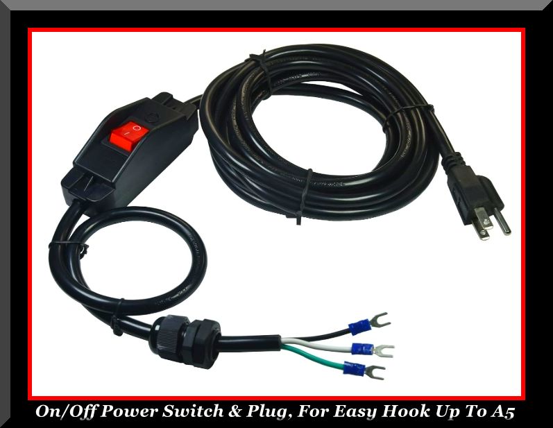

Very important:
Prior to buying a Acopian gold box version LPS, be aware they do not have an on/off switch. You’ll have to either buy a switch and incorporate it onto your power plug, or take a 3 prong power cord, and cut off one end of the chord, routing the three wires to terminate to the Acopian. If you do the latter than you’ll either have to unplug at the wall outlet after using each time, or the wall plug your using is connected to an on /off switch in your room. For clarity, the Gold box Acopians do not have on off switch, the Rack mount Acopians do. “But” both require terminating a plug onto the units.
(POWER CHORD MUST BE 14 GUAGE MINIMUM)
For safety purposes you also need to cover the terminal plugs too, since the terminals are exposed. A preventative from pets and children getting shocked. Acopian sells plastic terminal block cover plates, or you can make your own, very easy to fabricate.

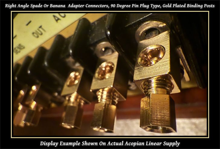

The four items to get you up and running, if you buy a Acopian LPS:
1.) 90 degree connectors are a very nice option to consider. Here is the link: https://www.amazon.com/dp/B0B7DD1P11?ref=ppx_yo2ov_dt_b_fed_asin_title

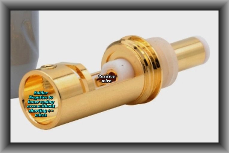

2.) DC barrel, connects onto back of Douk A5 power input.
https://www.amazon.com/dp/B09L4TCTS5?ref=ppx_yo2ov_dt_b_fed_asin_title&th=1

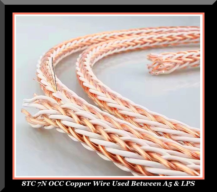

3.) The wire I used to connect the Viborg DC barrel the gold plated connectors
https://www.aliexpress.us/item/2255800641776414.html?src=google&gatewayAdapt=glo2usa
4.) Power plug with on/off switch and terminal already added, for those who want the absolute easiest method of getting your Acopian / Douk combination up and running quickly.
https://www.amazon.com/Conductor-3-Prong-Replacement-Terminal-Pigtail/dp/B0B85GQQRP?th=1
