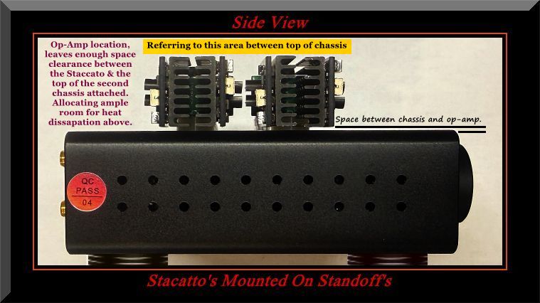

The bad news, you can't mount Staccato op-amp's correctly on a A5 circuit board without extenders.
Mounting without extenders!  :nono:
This is where I would mount Staccato op-amp's onto their zip tie mounts.
Even though your chassis is overall larger, I would still suggest using extenders for both Staccato’s
op-amps. For multiple reasons, I would mount both op-amps on the right side of chassis.
1.) Since Staccato op-amps operate in class A, I would suggest isolating their heat dissipation away from your main circuit board. Less heat near any circuit board, the better.
2.)With the flexibility of the extenders, your able to position the op-amp’s further away from your upgraded capacitors and their wire leads. Locating the extender / op-amps on the right side of chassis, you could  screw in a couple of black zip tie mounts, on the right side wall of chassis. Wrapping the zip tie’s between the wires of extenders, to the side wall of the zip tie mount is very easy and worthwhile step. Plus, having them both in the same position would have more symmetry in pairs.

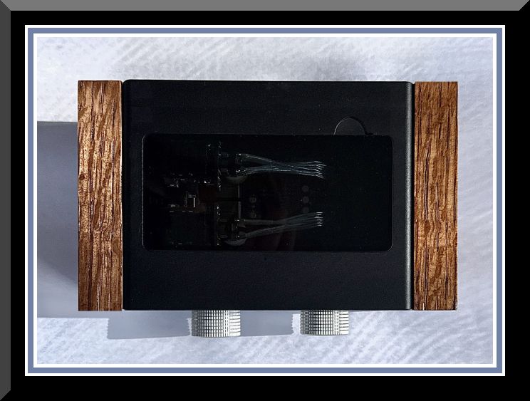

That is one clean looking build right there!!! Love it.  :thumb:
tremrej65
Super nice looking amp. Congrats.

Staccato op-amps mounted w/extenders
Shown w/ Stacked A5 chassis's, mounted with coverage protection.
