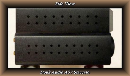

I've decided the Staccato's are going to be the permanent op-amp used with my A5, therefore, I'm building a hood cover to accomodate the taller Staccato op-amps. This is the design I have in mind. I already have the extenders and op-amps secured with standoff's. I like the bevel look personally. This allows proper protection of the op-amps, while improving the asthetics, versus them standing outside the A5's chassis in stock form. I'm going to have logo badging fabricated as well, and better quality isolation feet.
Op-Amp's mounted ready for a newly designed hood mount cover.
« Last Edit: Today at 06:16 am by NXSTUDIO-DRUMMER »
goggle1824
This probably isn’t going to be too helpful but honestly I like both designs! I have been looking and leaving and coming back and looking again, I’d be pretty content with either 😂🤦‍♂️, sorry.  Great job designing them, they both look super cool.
