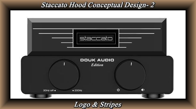

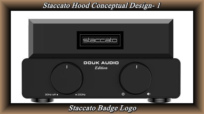

Douk/Staccato Chassis Mod
« Last Edit: 7 Mar 2026, 12:51 am by NXSTUDIO-DRUMMER »
goggle1824
This probably isn’t going to be too helpful but honestly I like both designs! I have been looking and leaving and coming back and looking again, I’d be pretty content with either 😂🤦‍♂️, sorry.  Great job designing them, they both look super cool.

Shawn, that case mod looks like it'll be great. I do like the little blue accents on there too. If you don't already have some House Of Kolor paint or something close sitting around, go pick up some Chrysler Hydro Blue (paint code PBJ). That's the real good looking blue on the new Dodge trucks & Jeeps. Looking forward to how this comes out.  :popcorn:

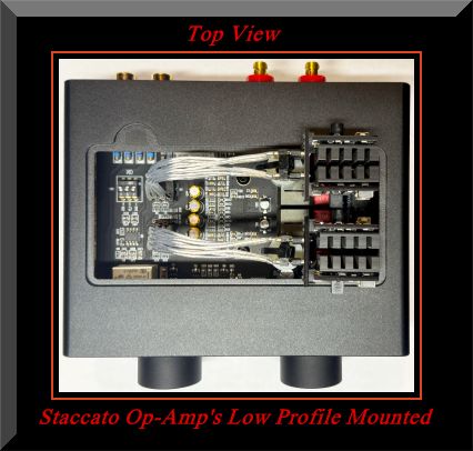

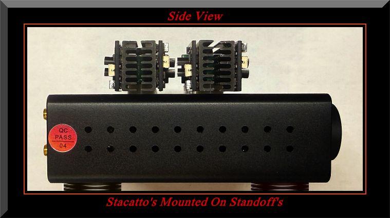

Getting close to completion of chassis modifications. Finished milling out the bottom of top chassis, to accomodate the Staccato op-amps. Attached the two chassis, using 4-8/32 x 1/4" Allen head screws. I had some .040 thick Sorbothane left over from my Mordaunt Short upgrade, so I cut a few pieces, and sandwhiched between the two chassis's. Help with resonance? ... can't hurt, plus I already had in hand.
The Air space between the op-amps and the top chassis is 1/2" clearance, therefore, they have plenty of ventalation. I frequently take the lid off anyways, if I'm going to play music louder, pushing the amp further.
With the new turned aluminum Isolation feet, I have more clearance, improving the cool air transfer through the bottom chassis vent holes. I'm also adding 3/4" solid oak side panels to the chassis. Appearance wise, when I viewed the amp, it's tall, but not very wide, so I made the decision to widen it, making it look more proportional to the big boy amps, by simply adding oak side panels. I'm not worried about covering the existing holes on chassis sides, since I remove the top lid for ventalation, the majority of the time. Another benefit with the A5 being powered by a LPS, the amp run's much cooler.

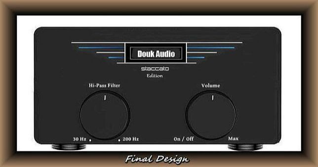

Still working on the front & rear cover plates currently. I'll provide more photo's of the chassis mod when completed.
For now, I've attached a photo of the side panels and new isolation feet. I've stained it in a walnut finish using General Finishes oil based Arm-R-Seal satin finish.
Looking forward to attaching my designed cover plates soon.  :thumb:

Once the front & rear cover plates are complete, that will be the final touch for the chassis modification.
Obviously, work is still in progress, the cover plates are missing. Photo's above, display what's been completed to this point.
After finishinig the panels, I'm going to secure the panels to the amplifier.
