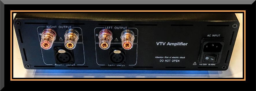

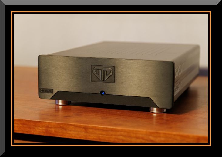

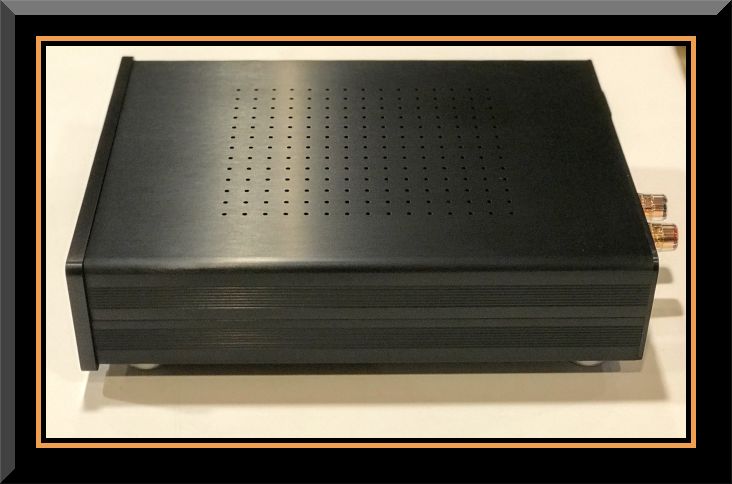

Is this an alternative knocking at the upgrade A5? or not door!
https://vtvamplifier.com/product/vtv-amplifier-stereo-hypex-nc122mp-ncore-amplifier-125wx2/
Hypex NCore Versus, Texas Instrumentss 3255? Comments welcomed!
