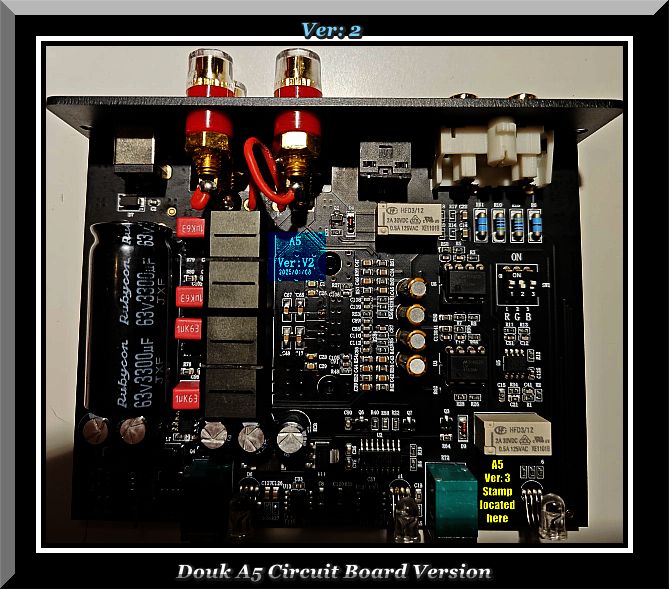

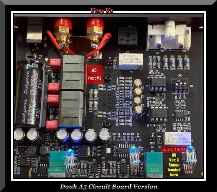

Note:
If someone should buy a A5, just be aware there are different versions of this model that have been produced. Later versions have the latest upgrades produced by Douk Audio.
Here are some photo examples that will help in indentifying which model version one may have.
I just zoomed in on my Ver: V3, I did show the location where it will be located on the others, highlighted in yellow. Notice on the Ver:V1 the production stamped date is in a different location. I highlighted it in red.
I'm still enjoying my Staccato op amps, they're TopNotch! :thumb:
nlitworld
  • Posts: 2728
Yep, my first one was a V3 (bought with 48v supply). When I toasted that board, I purchased another with 32v supply which was the V2. Only found out after I tore it apart making a bunch of mods that it was the older version. I can honestly say a V3 is a big step up in sound comparative to each other.
