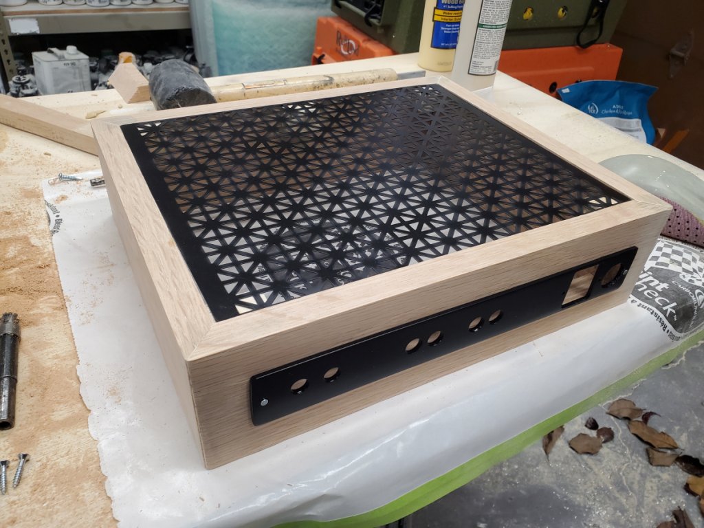

Was a little slower progress than I wanted, but case is built. Still need to stain it nicely, but it'll be good. I did find an aluminum sheet in the garage from an old Hammond chassis that I used for the bottom base. The open lattice should be nice for ventilation. Tomorrow and Monday will be a little tied up so likely won't bust out soldering iron til mid-week. You know I'll report back as soon as it's up and running.

The case you made is very cool! Did you mill the plate to hold the inputs, outputs and AC? I have not listened to any class D before, very interesting thread.

Yes, I bought a 1½ aluminum piece from home depot, and used my good ol Milwaukee drill and dremel to make the piece. Tube connectors will be glued into place just for extra secure hold, but everything else just snugs right in.

Step bit or twist bit to drill your aluminum?
I’m pretty interested in learning more about working with Aluminum specifically for enclosures, etc, but realistically, I’ll just be using more basic, powered woodworking tools and hand tools. I’ve been doing some searching online as well, does anybody have a really good link or source for good basics or entry level type tutorials? 😇🤔

I used a regular twist bit and dial calipers to double check sizing needed. I think I used a 3/8 or 13/32 bit for everything which is an easy fit for those rca but I have to wiggle around and open up a smidge for the tube connectors. One day I'll get a real 7/16 bit for tube connectors, but no big deal.
You'd be surprised how easy everything is with a few basic tools. Jigsaw, cutoff wheel, dremel, drill and saw and you're good to go.
