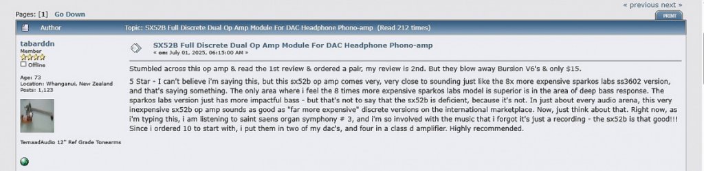

I've heard and read favorable reviews on a SX52B OP-Amp.
« Last Edit: 19 Sep 2025, 03:57 pm by NXSTUDIO-DRUMMER »
