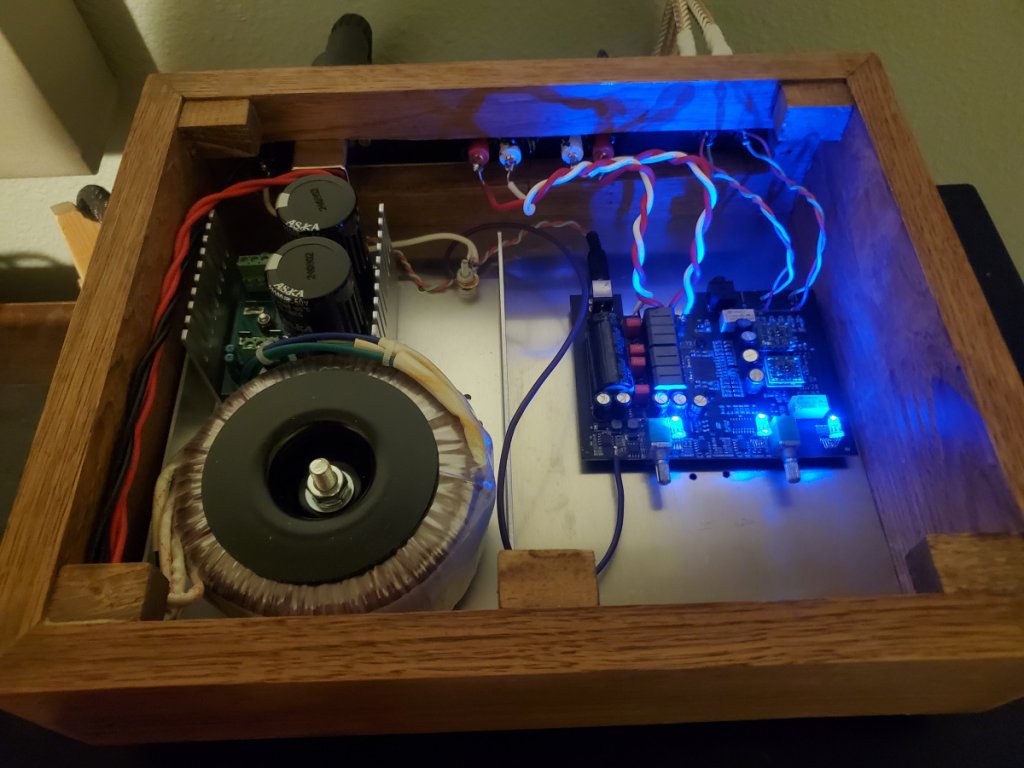

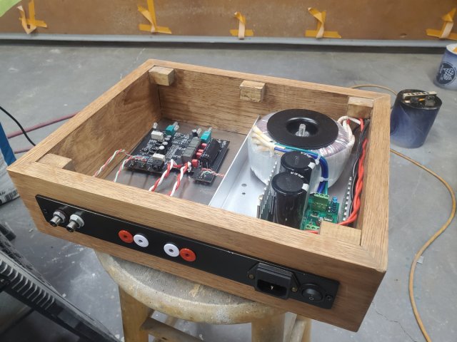

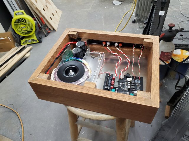

Made all the changes today, case looks fantastic...... but it doesn't fire. Not sure if I toasted a part on the board or if the little tiny button on the front of the board actually does something as a safety measure. ¯\_(ツ)_/¯   There is power to the board, the main cap has 58v across it, but can't verify power after that and no lights or any sound. I didn't pull off the volume pot just yet, as I figured baby steps in mods. Either way, I'll do some troubleshooting to find out and worst case scenario I start over after buying another for $80.
But it looks great in there. And yes I know I accidentally drilled the board a little crooked.  :duh:
P.S. if anyone is planning to desolder anything on this board, you'll want a minimum 60w 750° iron as their lead free solder sucks to melt. I went and bought a big fat Weller 900° gun just because of this.

That looks so freaking cool!!😎 👍🤟

nlitworld
  • Posts: 2722
It's alive! Sometimes you do a big oopsie somewhere and just need to start with a new board. Snagged a new one, mods all redone as well, and just left the DC input and wired a plug. I'll let it play for a while, before assessing difference, but right now it sounds great and looks even better.  8)
P.S. I still say doing these mods necessitates dual soldering irons. Also the little tiny button tab near the high pass knob is actually a ground connection. That's now hard wired to a star ground in the middle (purple wire).

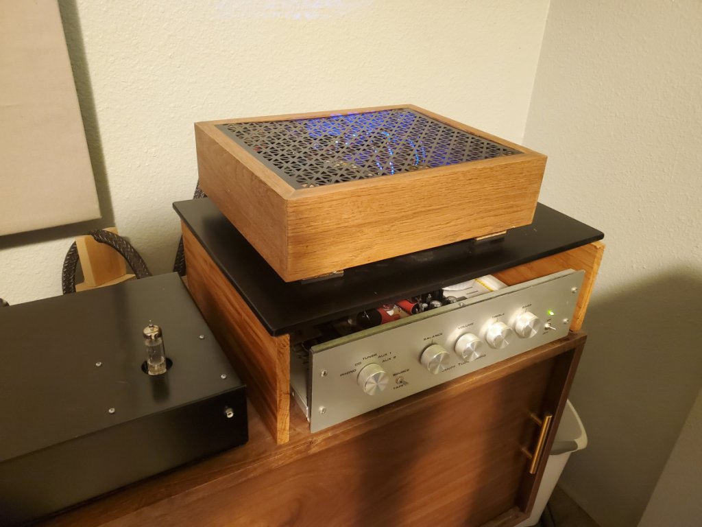

nlitworld
  • Posts: 2722
So chassis is all sealed with some minwax polyurethane stain. Nothing fancy, but it richened the color a little. The amp runs super cool in the new case. The bottom is aluminum sheet and barely over room temp to the touch.
As for preamp and cables, it's a legit tube preamp with tube rectification. I do have Gold Lion 12ax7 and nos RCA 5751 tubes in there which arent exactly known for smooth and mellow sound either. Cables are GR Research IC8 which are all copper but very articulate. I could try and swap my Hapa Ember cables in the mix but sound signature is very similar of articulate clear copper.
As for the sound of the amp itself, my plan is to let it burn in a couple weeks, also keeping it on 24/7 for a few days to see if it's better that way. I also found where I messed the old board up in the front corner, so I'll try to mend it (scary tiny smd resistor soldering). If that does work again, I'll swap back to V3. Douk did confirm some changes for bass response between the two, as well as the V2 low pass is 30-300 vs the V3 being 30-200 filter. All in all, the V3 was definitely better, but not exactly worth buying yet another just to get that board back.
So yeah, plans are to let it burn in, also set some nice miflex low pass caps in there (~8K ohm input) so a couple 0.22uf are on their way from Sonic Craft. If I really get bored, I'll swap those Nichicon for a set of small poly caps just for fun. Experimenting is worth the $30 just to tinker. If I was looking outright best sound, I'd look elsewhere. This is a fun little project and great to listen how each component changes the sound.

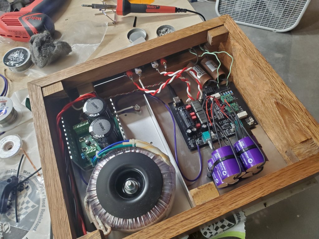

nlitworld
  • Posts: 2722
Soooo, I went all out on goodies last week and installed today. I'm done, this is rad and I'm not messing any more. New updates are Miflex high pass caps (0.22 for around 90hz rolloff), Clarity CSA caps for replacing those Nichicon KZ caps, and updated the grounding scheme to also go through the LPS. Now everything is dead silent BLACK background, smooth taper roll off, and way smoother and richer sound. I'm super happy with the sound.
All in, I'm probably $600 invested for everything if you don't count count labor hours cause was just fun tinkering time. Most would say silly investment, but I'll loan it to "Douk It Out" if you'd like to spin for yourself.  8) Just let me get some burn in time on it with latest updates.

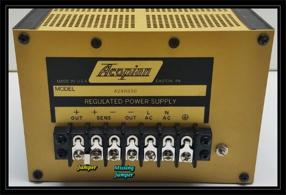

Based on shared experiences between the various Acopian LPS's, the A24H850 is the most practical for those on a budget. I received some data from a friend I sold my old Acopian A24H850 LPS. He took some measurements using the NIOSH Sound level meter app, I've provided for download on a later thread on here. The reason being it could be a general reference tool for anyone interested.
Thanks!. Just ordered an A24H850 from eBay.
Enjoy,
If you have any questions and need any assistance I'll be glad to help, just PM me.
