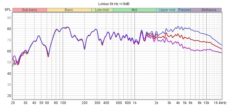

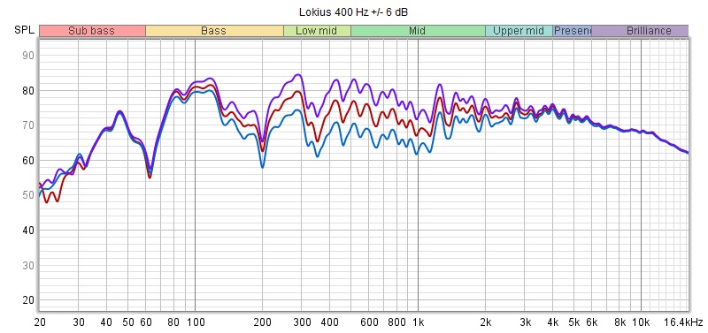

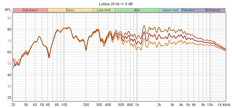

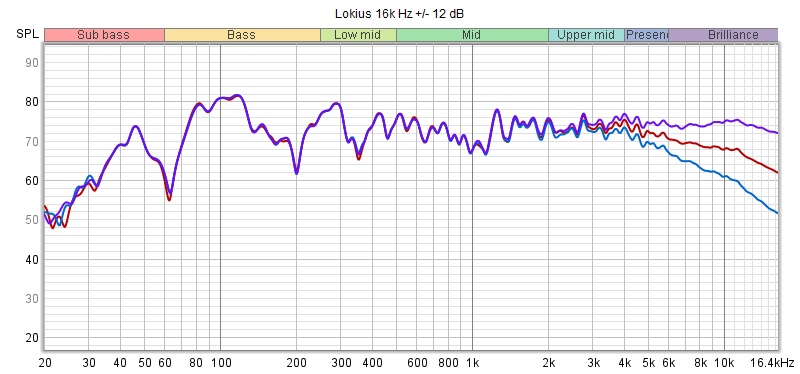

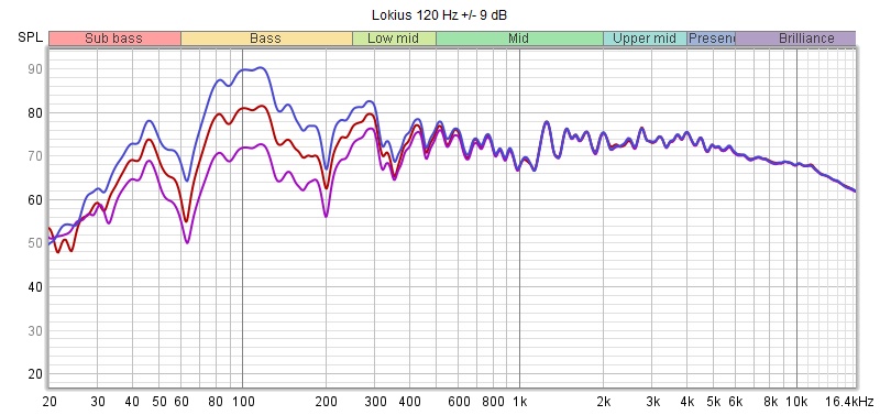

I got a wild hair last time I had REW out and grabbed the frequency response range for each of the 6 bands which I though y'all might find interesting.  You can see each affects response at multiples of the center frequencies.  The center plot (red) in each is baseline without EQ.  The other two are the specified band at +/- 100%.  All are 1/12 octave.
The only thing I'm not wild about is the unequal and limited central frequency responses: 20/16k +/- 12 dB, 120 and 6k +/- 9 dB, and 400/2k +/- 6 dB  I'm sure it's perfectly fine in most instances, but replicating the hearing aid correction will take more than 6/9 dB at 2k and 6k.  Though, to be honest, I probably wouldn't crank it up much for that I already have.
