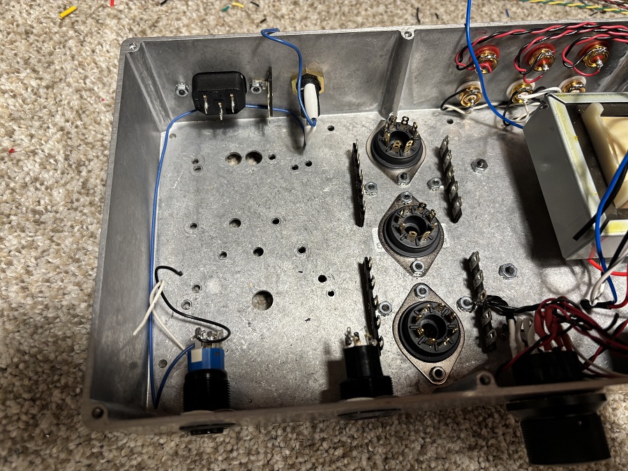

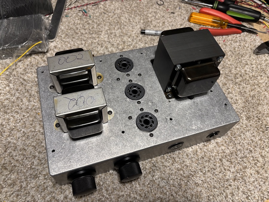

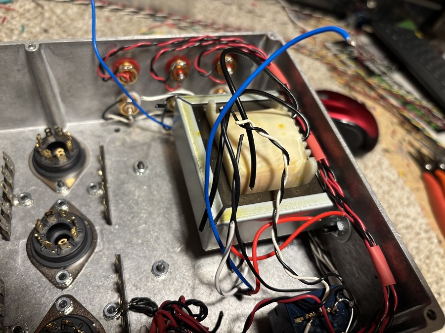

I have the prototype up and running.
 It uses a 6SN7 driving 6V6's configured in Triode.
 Once I get it dialed in I'll cut the other chassis and take them to the powder coater.
straitwire
  • Posts: 59
Re: Straitwire SW-1 headphone amplifier
« Reply #17 on: 9 Nov 2025, 11:39 am »
I have the the proper output transformers, power transformer, and choke now.
The output transformers are made to my specifications for the 6V6 and the power transformer is spec'd to work in this amp, and in pretty much any amp I design in the future.
The new choke is massive but it still fits if I mount it on it's side
I originally built this prototype with power and output transformers that I already had lying around in order to configure the layout while I was waiting on the iron, and to help me determine what the B+ voltages were after rectification in this circuit, so I knew what to spec the high voltage winding at.
I'm finalizing the power supply now.
  • Posts: 21768
« Reply #18 on: 9 Nov 2025, 12:56 pm »
Great cast chassis  :thumb:
