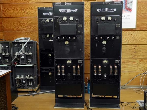

Thanks.
Building on the original question -- let's say I want to build the ultimate amp. We know that premium capacitors tend to be significantly larger. Do higher quality transformers and chokes tend to be larger in the same way that premium caps are larger? Will a single-chassis amp be a size limitation to achieving superior sound quality??
No, but WAF on a very large chassis may be more of an issue. Vintage tube amps could get to be very large. An "ultimate" tube amp will indeed have some very large caps and coils, but there are many options for packaging. My own tube amp has a separate chassis and power supply for the driver section and the output uses no electrolytic caps whatsoever and a choke-reg PS, so in total my 6w 2-stage tube amp is well over 50 lbs of stuff. And that would be just a driver for a large tube like a 211, a 211 output built like my EL34 output would be a very large amp weighing well over 100 lbs.
