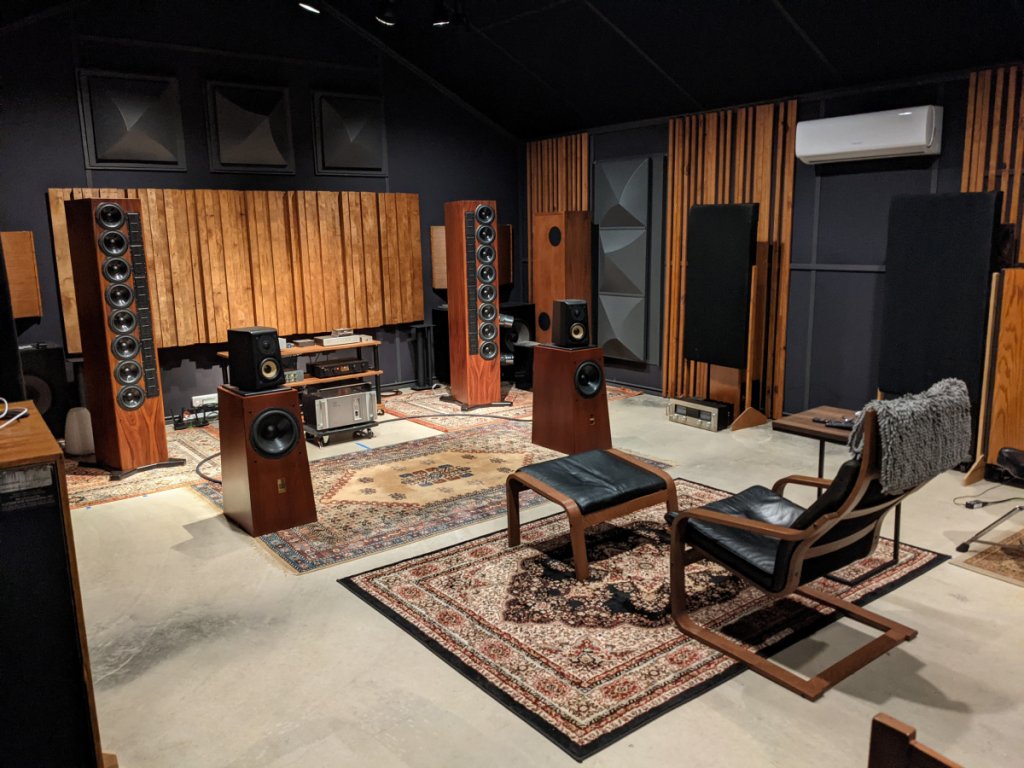

Thanks for the compliment. I'm probably equally enthusiastic about acoustics as I am hifi, so I maybe take it a little further than most. Suffice it to say, the effort pays off handsomely every time I sit down for a listen.
That said, building that room was a bit of an investment, so unfortunately the budget can't support four triples. I'm sure it would be extraordinary. Sigh

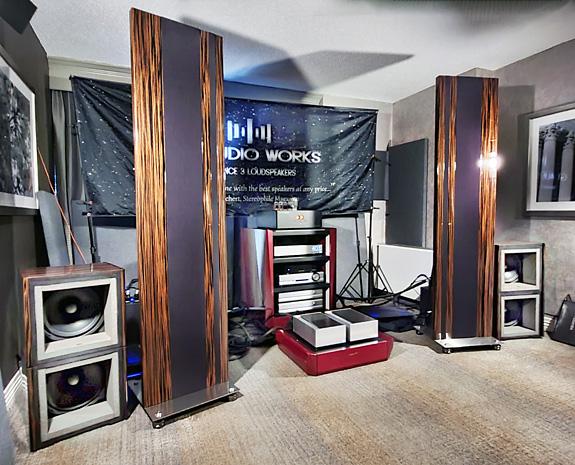

« Reply #18 on: 29 Jul 2025, 01:30 pm »
I like GT Audio Works OB active subs. Those subs are well sorted and use new drivers and AudioControl RS1000 external bass amps. Unfortunately I can't fit a pair of them (incl: the bass amps) in my apartment, so i'm going with a single Rythmik F12SE sealed servo sub. But if I moved into a house, i'd upgrade to Greg's OB subs for sure (see pic below).
