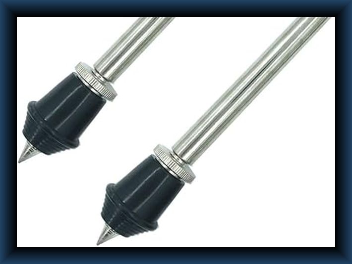

I couldn't agree with you more Danny.... That's why I use spikes on my subs, or any other equipment whenever possible, to minimize surface contact. Of course there are many other dampening products alternatives too, most of us are aware of. However, spikes are the most effective for my intended purposes.
I use spikes on my subs, but since they sit on a hardwood floor, I have discs underneath the spikes to protect the floor. Does the use of discs negate the decoupling effect?
NXSTUDIO-DRUMMER
  • Posts: 267
I've used coins under my spikes with success on hardwood floors too, your fine. At this point, one would be splitting the atom. :lol:
Plus the sheer weight of your sub, more than likely, isn't going to shift on your hardwood flooring, with a dime underneath each spike. IMO, I don't see it causing any negating issues.
« Last Edit: 17 Jun 2025, 08:22 pm by NXSTUDIO-DRUMMER »
Danny Richie
My (somewhat) rule of thumb is that if the floor is concrete, spike it straight to the concrete. That concrete is solid and doesn't move. That is what you want for your speakers and gear.
If the floor is lossy (can move) then all of those dampers can really come into play.
