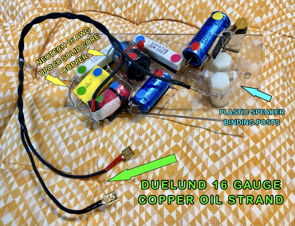

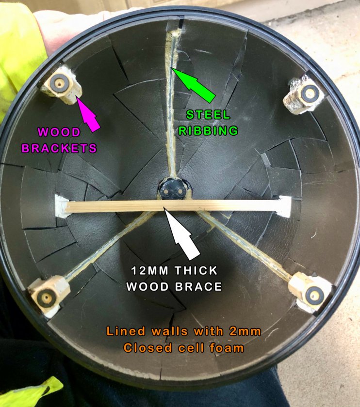

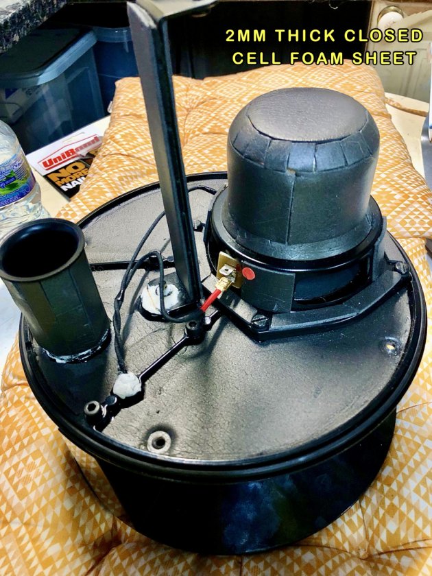

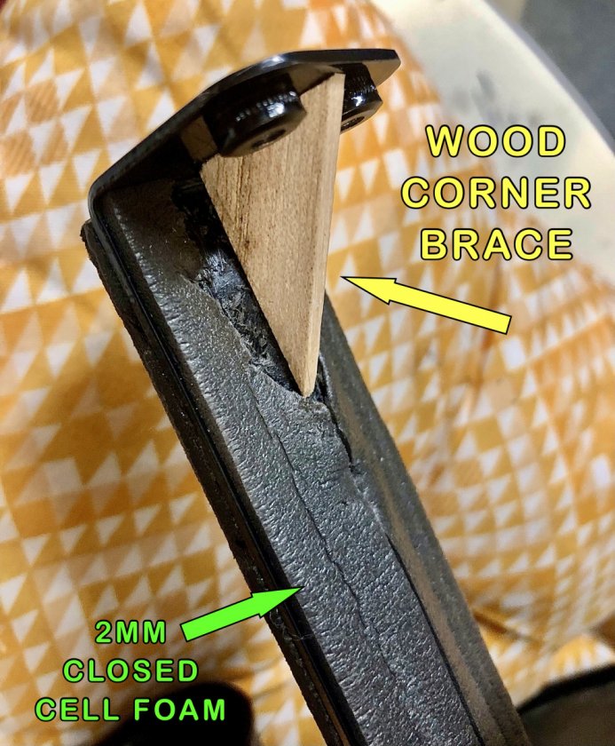

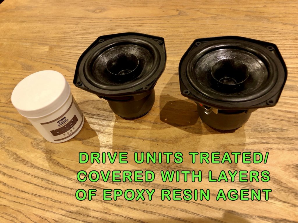

I started this thread to document the extensive modifications that I did to some vintage 1991 Canon S-50 Wide Imaging Stereo loudspeakers. These are some of my favourite speakers as a child, bringing back some wonderful memories. The looks are straight out of Star Wars. Unfortunately, due to restrictive internal cabinet space limitations, I was not able to install exotic capacitors. However, I did re-engineer the cabinet structure internally to improve the vibration issues, and also removed any unnecessary components/parts in the circuit board, to get the cleanest most minimalist signal path, free from distortion. The finest wiring from Neotech and DUELUND with cotton sleeve was also installed.
The end result after modifications, produces some of nicest sounds that I have heard. Bass and treble response are both significantly extended/improved at each end. Basically the original issues of ‘rolled off bass and treble’ have been rectified by the modifications.

Some images…

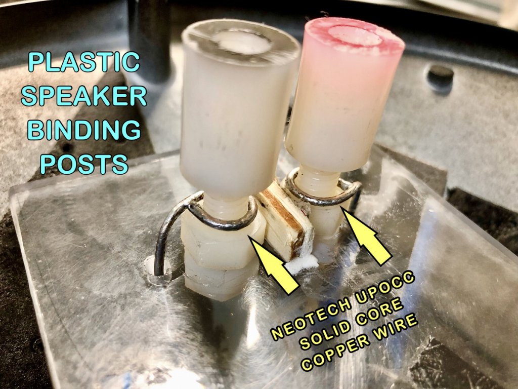

New clear perspex circuit boards with all point to point hardwired components…
« Last Edit: 1 Jun 2025, 02:17 am by OSIB16 »

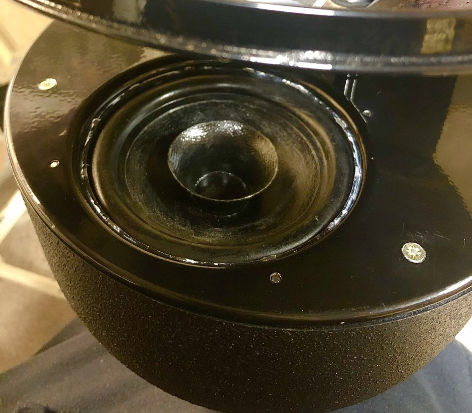

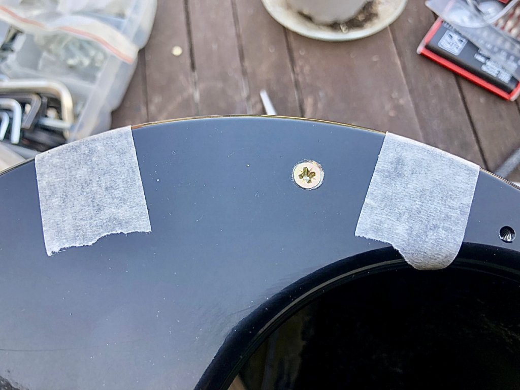

Grilles have been permanently removed…

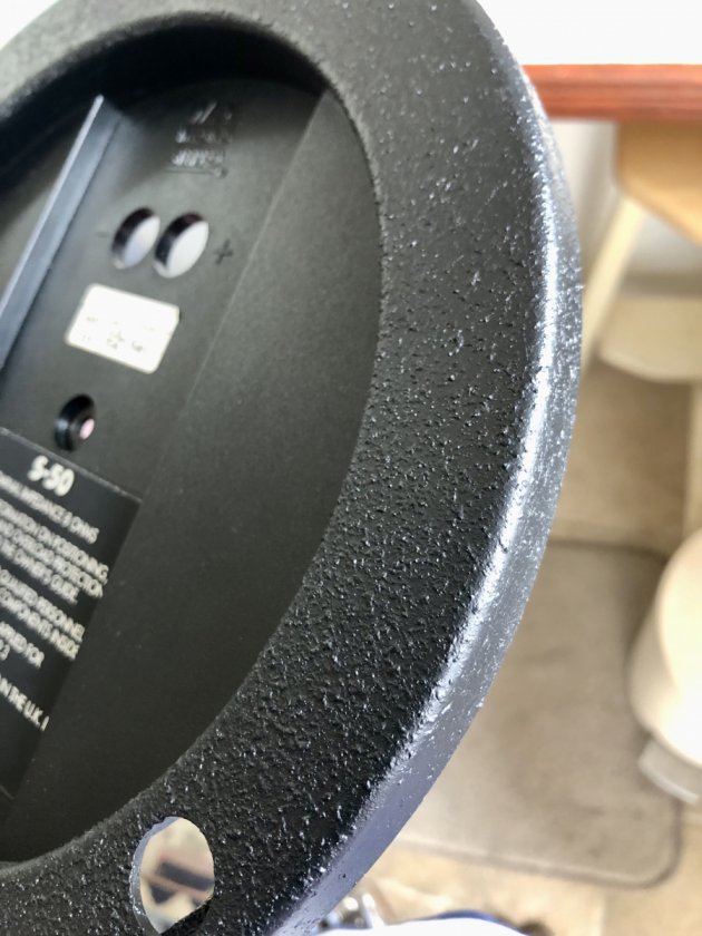

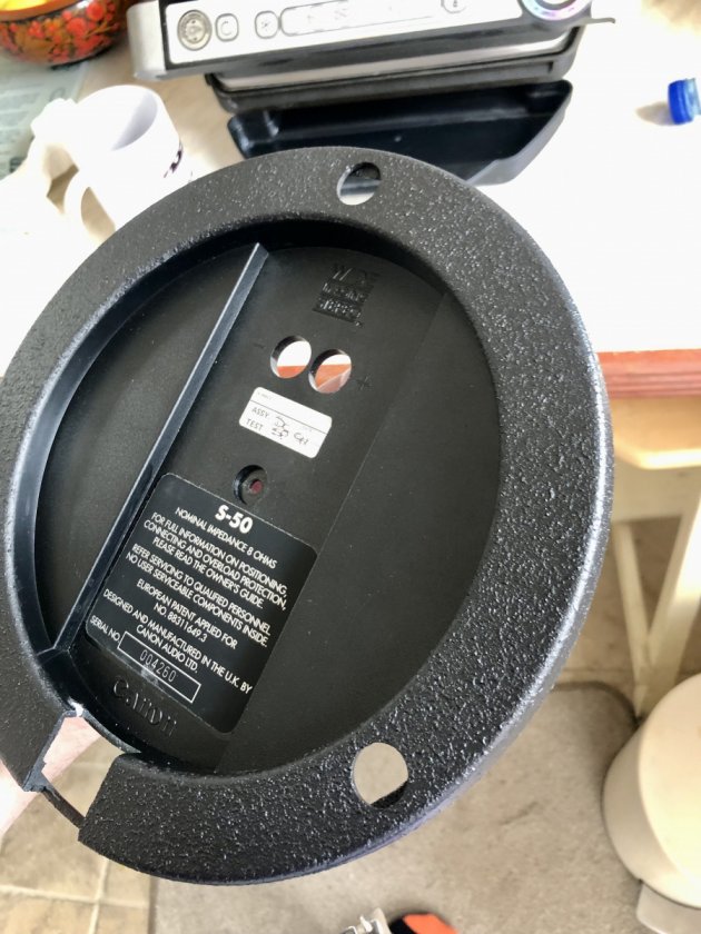

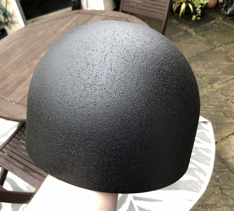

« Reply #6 on: 31 May 2025, 08:36 pm »

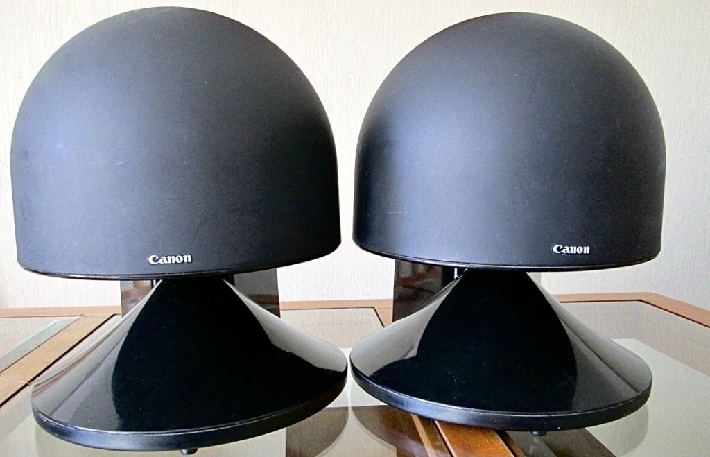

Repainted the domes and bases in a granite finish black paint…

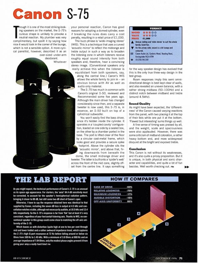

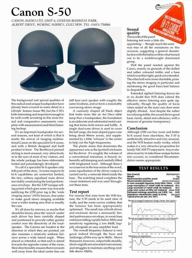

All time classics, without a doubt. Here are some old Hi-Fi Choice reviews I found on the web…

toocool4
Re: CANON S-50 SPEAKERS (SUPERCHARGED MODIFICATIONS)
« Reply #10 on: 31 May 2025, 08:59 pm »
Nice, did not know about the S-30, I think I remember the S-75.
OSIB16
  • Posts: 390
« Reply #11 on: 31 May 2025, 09:03 pm »
Yeah the S-30 came out a few years after the S-50. However the S-50 were larger and more substantial with more metal parts, even though the S-30 had improvements to the structure. However, I’ve fixed these issues on my speakers.
