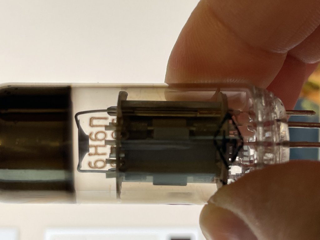

I just acquired a lightly used Pacific II, balanced, no volume control.  DAC was built in 7/23, used for awhile and then traded to a reputable dealer who has had it sitting for 14 months. I now have it, am waiting for a better-than-included quad of DHT tubes and an AES cable for CD transport. The factory DHT quad had been replaced by a NOS set that I don't want to try--not sure if they are good.  My questions are:  After installing new DHTs,can I power this DAC up as is, or should I try my variac for a more gradual start up.  (Not even sure if the DAC would respond a lower voltage until a certain threshold is met.)
Another question: When I do power it up, does it need to be under load as in, connected to my preamp, or can I try it without resistance?  I just want to make sure it powers up ok first.
Last question: I received in the flight case the factory box containing the KR 5U4G and the 6H6P dual triodes that Lampizator supplied, but they are stamped as 6H6U, but that U is actually an upside-down U on tube.  I have read Lampizator only likes the Russian 6H6P, but the tubes I am looking at seem to be an equivalent? Please see photo.  Ok to use?

Congrats on the PAC 2. 14 months is nothing. Full voltage should be ok. Partial voltage might confuse the digital sections which won’t turn on until a voltage threshold is reached.
The rectifier and anode load tubes provided are fine. Same ones I ran in my Pacific.
The unit can be powered without a load connection.
Which DHT’s were provided? Many flavors possible.
It is possible to run it SE by only using two output tubes (all left side, if I remember correctly)
Are you sure it is a PAC 2? Does the spec sheet or labeling clearly indicate this? They haven’t been available very long, but forget the date of introduction.
Edit: Pacific 2 introduced 5/2023.

Jarbs, just the advice I've been looking for--thanks so much.  I did obtain a factory build sheet corresponding to the serial number, and the DAC has the identifying plate on rear panel: Pacific 2, Balanced, Engine 11.  Will be receiving a set of EML PX4 Mesh, as originally supplied but not included in this sale.  Not sure why EML's were held back by original owner, but the Philips MRO PT8's provided I do not want to risk trying, as I do not know of their condition.  Although 'vintage', I don't see that they are anything special.  I did get the factory KR 5U4G, though.  My dealer also included a Takatsuki TA-274.  Although I have ARC tube gear, I have never had a custom tube DAC and have always heard great reviews on Lampis.  Again, I really appreciate your advice.
