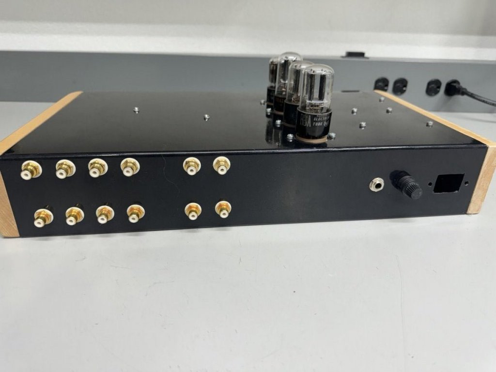

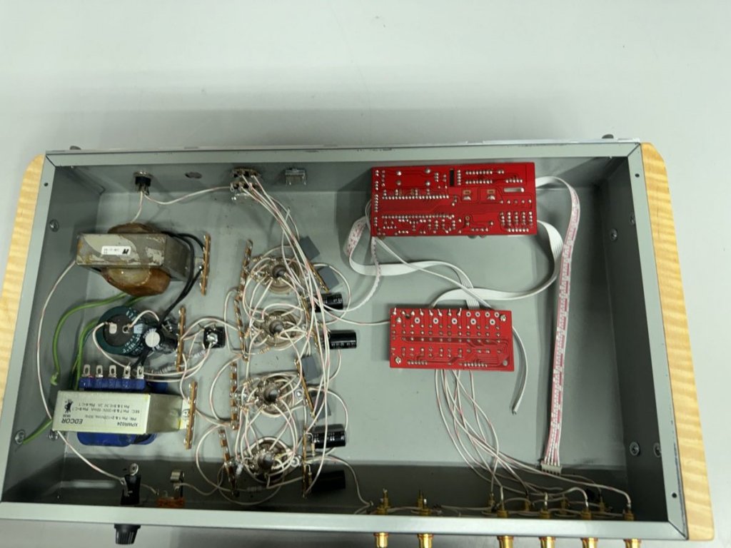

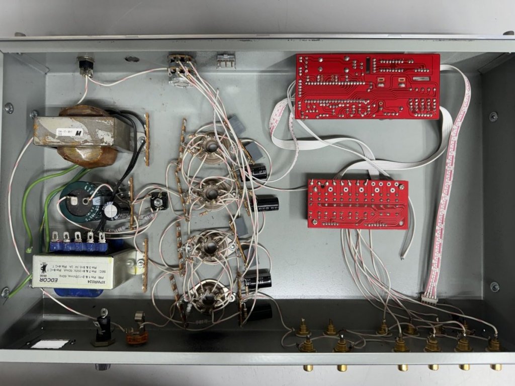

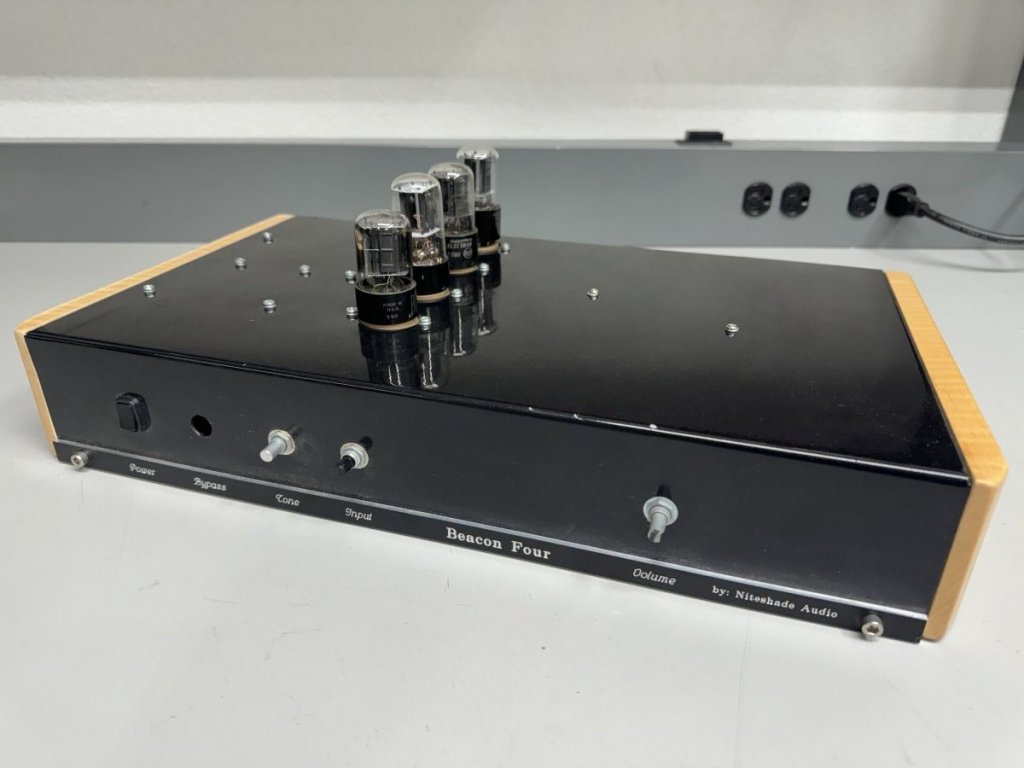

                 Really hoping to get some info and help on this. Bought a bunch of stuff fro a friend of the late Blair and this was included. It is the preamp he talked about and was pictured in his post. Does anyone else have one of these?  It has two printed circuit boards that are not completely wired to the rest. Most of the tube section is wired. I assume it is a dual beacon 2 with the other circuits for. Volume control and input selection. It would be great to get this going.

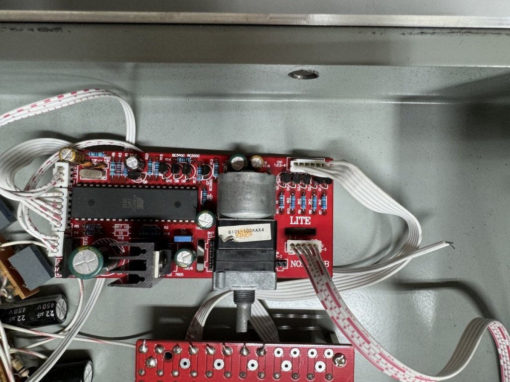

If, in the end, you're unable to build the exact Beacon, or the schematic therein, you have most of the parts there to make a preamp using another circuit. If I'm reading your pics right, you have four 6SN7s (a fav of Blaire, iirc) so you could find a mu-follower circuit online. You'll likely have to adjust the power supply circuity a bit.  The red PCBs are for remote-controlled volume and relay-based input selector. If you don't have the accompanying remote you may want to scrap those PCBs. They'd need a separate power supply anyway.
The good news here is that you already have the most expensive parts; transformer, choke, chassis and tubes. You should be able to make a good, traditional tube linestage preamp for not much more money.

Yes that's what I was thinking. I could ditch the remote volume and relay switched inputs and concentrate on tracing out the tube circuitry. Thanks for the advice.
