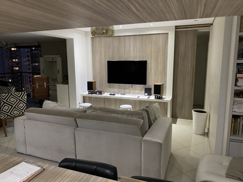

The picture below shows the listening room. For the moment, I have Audioengine HD6 speakers on IsoAcoustic stands. I'll be replacing them with CAMs on larger stands.

You are well on your way it seems.  That tube amp should be a good match as well as your music taste.  4-12 watts I would guess, depending on tubes and triode/pentode mode.  Definitely get better than the JJ stock tubes though.  Even new production Gold Lion EL34 would be an improvement.
Why a passive preamp when the amplifier is integrated with a volume control?  For a remote maybe?
You have a challenging room with that wall on the left.  If at all possible, get floor stands and have the speakers setup in front of that shelf.  Particularly important if Louis put the ports in the rear.

You should put them on stands on the floor and experiment with a nearfield positioning. This could reduce the influence of the various flat surfaces in the listening space.
Maybe push the couch back a bit to free up space, if possible.
Definitely experiment with toe-in and placement, because that will have the most significant effect on the sound.

@ newzooreview thank you, I was hoping that the Audioengine would be enough to break in the speakers as I only have this amplifier at the moment. I was afraid it would suffer from having to run non-stop for 5 or 10 days while the speakers were being broken in, but you've reassured me. I agree with you that it would be preferable to use stands for the speakers, but for the moment I'll have to use the CAMs placed near the front wall on the low cabinet with IsoAcoustics Aperta 300 stands, like Audioengine currently use with IsoAcoustics 155s, because the listening room is also our living-dining room and I'm not going to be able to encroach too much on the living space. On the other hand, you're right, I'll have to test different listening positions and I'll modify the position of the sofa accordingly. I was also planning to use the near-field listening position to avoid reflections from the room. To compensate for the reinforcement of the sound from the left speaker by the wall on the left, I'll move the right speaker slightly forward in relation to the left. I've seen this work with the Audioengine speakers I'm currently using. We'll see when I've got the speakers and I've broken them in, because for the moment it's all a bit theoretical. Anyway, thanks for your advice.
