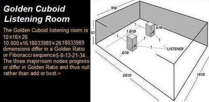

A good audio room is the Golden Ratio (no room treatment need.).
But the Cardas Golden Trapagon is better.

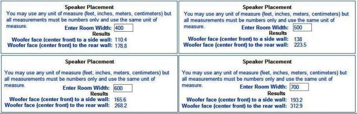

« Reply #2 on: 30 Apr 2025, 05:03 am »
JLM

I had an 8ft x 13ft x 21ft room, just a smaller version of above (limited by ceiling height).  It was all insulated drywall, except for the carpet over concrete floor.  The interior partitions were staggered stud construction even though the spaces on the other side were storage rooms.  Used a fiberglass insulated exterior door with weather seal and flexible lined/insulated ductwork (could barely hear the furnace fan).  Builder refused to provide a suspended ceiling construction so I could hear footsteps above.  It was in the basement (no windows) and opposite all living areas upstairs.  So nearly perfect.
I added GIK 244 panels but they were barely needed.  I lent them out to a restaurant that had a serious noise problem and they ended up buying (23) 242 panels.  I took them over to a friend's place and they made an immediate improvement.  I used the Cardas formula for speaker/listening position setup (mid-field).  It was ideal.  Unfortunately we've moved the the room in the new house is too small for a mid-field setup (even for monitors), so I've reverted back to using headphones which for my failing hearing is OK.

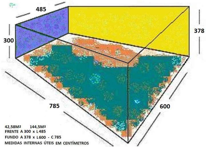

I remember an article many years ago that started with a “Golden Ratio” for a dedicated listening room, then made sure that the walls were non- parallel, increasing width and height from the front to the back. Special Materials. Double-studded walls. Lots of details.
But, definitely- Golden Ratio.
Golden Ratio is only special because it has irrational ratios, many nrooms with different irrational ratios work.
But the biggest bdifferencemismmade with a sloped ceiling.
