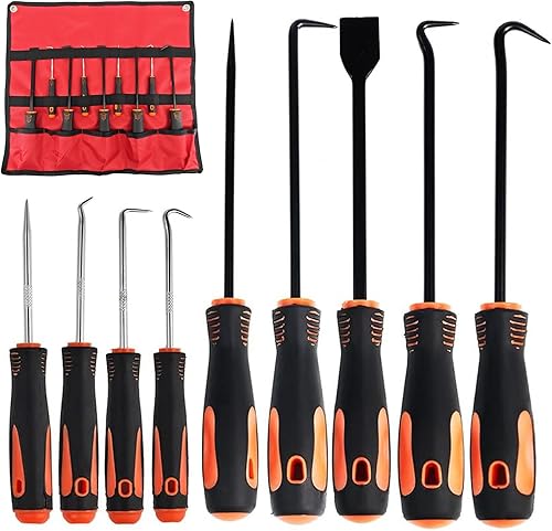

Just a thought, but you might try something like this
Insert one or two thru the mesh, gently pull to see if it will pop back in place. Good luck with the fix.
