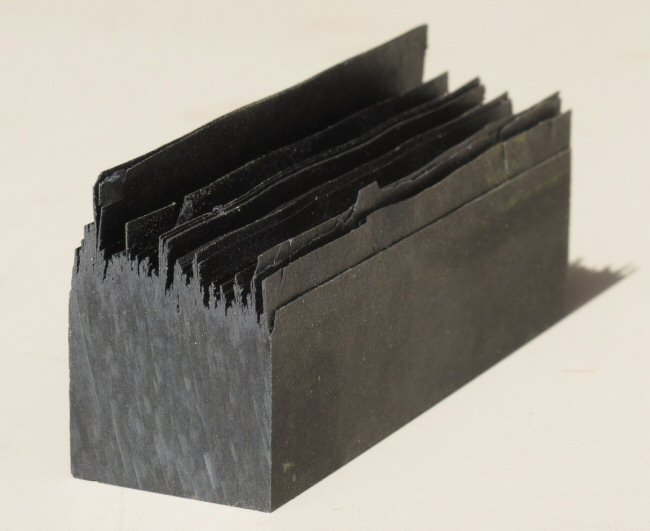

I was thinking of sandwiching the ply, mdf and acrylic...
I would substitute Richlite for the acrylic, the material is very dense and naturally non-resonant. Richlite is made from layers of recycled cardboard or cellulose fiber and phenolic resin.
https://www.richlite.com/
The photo below showing the layers is from the sample kit, Richlite is impossible to break and would never look like this if you could break it.
Richlite is dense, a 6"x6" square of 1" Richlite will weigh 1.6 lbs.
