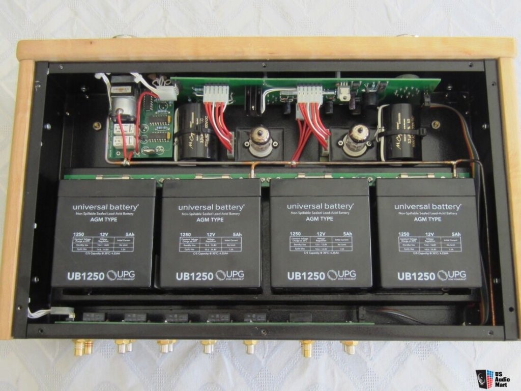

What exactly is a battery bus?
A "battery bus" is the wiring that connects a bunch of smaller batteries together so they act as a "single" battery.
In the case of some early designs it had 4 batteries with 2 battery busses where one bus would charge as the other is being used.
Some models also had all 4 smaller batteries wired together in series-parallel for improved dynamics, (1x 20AH v 2x 10AH)
Tater models removed the smaller battery in favor of a smaller chassis, and a single external 12V 110AH AGM battery, which are kept charged by small Ctek 0.8A trickle chargers.

NoahH
  • Posts: 408
Re: Running off the Grid
« Reply #18 on: 13 Apr 2025, 09:29 pm »
@brandonb - I have one of the bigger 4 battery Dodd preamps that I am thinking about selling. Oing me if you are interested
