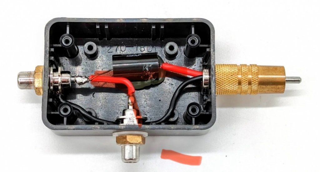

This is the right way to do it: https://gr-research.com/hi-pass-filters/
Thanks fr your input Danny.
From reading your document.
I’d be best to build that simple box … that has one input & 2 outputs… one filtered one not.
Plug that in from my AVR pre amp output … with
Filtered going to mono block amps then to X-Statics.
The  unfiltered output going to the line in of the Rythmik plate amp.
Thus don’t use outputs from plate am at all.
Correct?

« Reply #16 on: 3 Apr 2025, 11:25 pm »
Actually, eyeballing the project box. I see both outputs are filtered.
Could easily do my way… or just use a Y cable on the line out pre amp signal from AVR.
If you look carefully, you'll see only one output is filtered. The filtered output goes to your mono block amp. The non filtered one goes to the line in of the Rythmik plate amp.
I'll send you a picture of mine, but they are not built yet. Maybe this weekend.
Theronbo
Re: Double Trouble X2 Build
« Reply #18 on: 4 Apr 2025, 06:52 pm »
I did look carefully.
Both outputs are filtered.
But, easy enough to do either way.

« Reply #19 on: 4 Apr 2025, 07:00 pm »
The left RCA female is the input from the preamp.  The middle RCA female is the sub output and the right RCA male connector is the highpass and goes to the normal amp.
