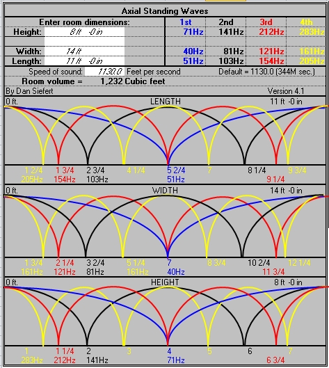

Movie nights on the sofa must be fun with 103 Hz, 154 Hz and 205 Hz standing waves at the back wall adding heft to action movies.
Your room dimensions plugged into the Harman Room Mode Calculator - a tool to play with after reading Part 2 of "Maximizing Loudspeaker Performance in Rooms" that has detailed information on how to interpret the graphs.
https://www.audiocircle.com/index.php?topic=58304.0
