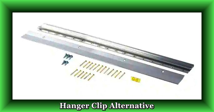

Here is another fastening alternative, one could use, building their own diffuser panels, that works well. Home Depot sells.
 https://www.homedepot.com/p/SIMPLE-MOUNT-18-in-Apartment-Hanger-APT-18/205948444#overlay
