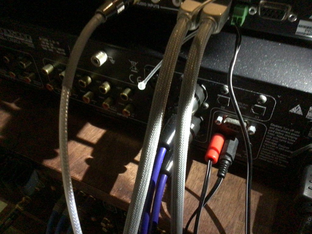

I have a BP173, 3B3 and  BDA2. Similar to your equipment,  the  BP173 triggers use a mini mono jack and the amp and dac use the bare wire connectors. The inputs are only looking for voltage so there is no need to worry about which wire is connected to the tip or sleeve of the mini jack nor which wire is connected to either of the connectors going into your amps. Pardon the dust.
