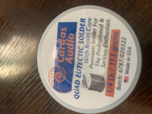

Could you give me more details on the type of solder that you know will work? I've been using solder that came with these kits. I thought it might be suspect. The flux that comes with the kits is not great either.

Cardas Quad Eutectic Solder is what was suggested to me.
Gold standard right there. I'm sure Danny is sending out competent product with his kits, but unsure if this is what's supplied or not. Only time I've varied from this was soldering surface mount pcb parts and needed Itty bitty skinny solder. Added bonus, Sonic Craft always has in stock and usually get in 3 days or so.
JCarney
That solder works well, it was recommended to me as well and it’s all I use now.
I struggled to solder tube connectors at first as well, but getting a lot of solder on your tip and use a larger chisel tip with more heat, 850 is where I set my iron. Give the wires time to heat, if you are concerned about overheating components, use clip on heat sinks to give you peace of mind. I also use flux to help the solder flow, you should be able to see it flow all the way through the tube connector.
