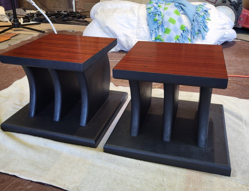

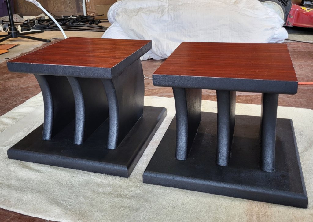

I am still waiting for my wire order. I don't have a tracking number so it shows up whenever.
The stands are almost done.

These stands are complete. I received the wire I needed last night so the plan is to have the speakers working by Sunday evening.
Re: The Bully Build Begins
« Reply #186 on: 5 Aug 2025, 08:48 pm »
Those stands look great! Impressive work!  :thumb:

It's hard to imagine this type of work through someone else's eyes. When I look at them, I see what's wrong with them.  :lol:

Haha, no matter how many projects you do that turn out phenomenal, it's hard to turn off the self-criticism. For as good as your stands and Bully's look (and they do look really damn good), I'm sure they're going to sound even better. Really looking forward to reading that part of the journey. :thumb:

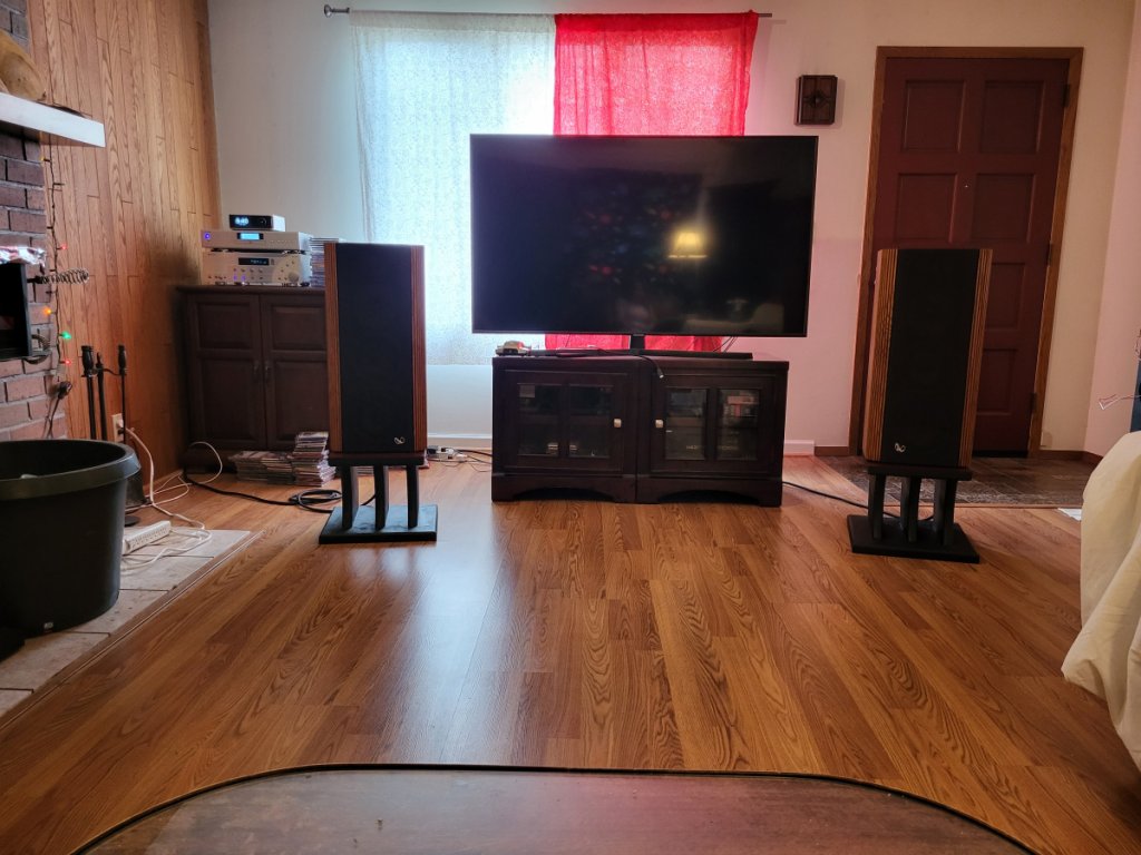

I put my Infinity RS5 speakers on the stands last night with Herbies fat dots. There is a complete absence of vibration in the floor. That's going to take some time to get used to. My whole life, I've only heard speakers sitting on the floor and shaking the room.  :|
Early B.
« Reply #190 on: 6 Aug 2025, 06:22 pm »
Oh, just wait until you drop those Bully's on the stands. It will be a complete -- "Oh, WTFJH??" moment.
