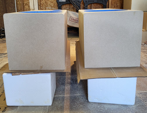

Thank you for the picture!
I had an idea to mask off my speaker in a similar way but on the inside. After thinking about it some more, the front baffle is so narrow near the subwoofer that any masking would become part of the glue line. I opted not to mask this way on the inside.
The face of my speaker can't be covered because I need to sand and paint it. So far, masking the holes with tape seems like a reasonable method. I had a friend suggest using some rigid foam to cut plugs that fit in the holes. Cut the plugs oversized slightly so they fit tightly. I'm not sure how I feel about this approach. I've spent an obscene amount of money building these so far and I really don't want to spend any more if I can avoid it.
-Rob

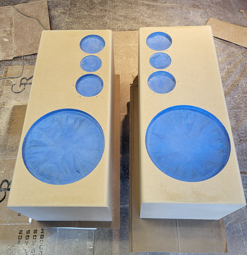

I think the painter's tape worked out alright. I'm using 2" tape to close up these holes. I haven't taped the amplifier openings yet since it isn't quite needed yet.
After this, I won't have much to post until I start applying finishes. It's pretty hard to show off any sanding that is completed.

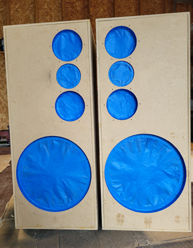

This past weekend I did a little sanding. All of the wood putty is applied and sanded except for the bottom (my hand truck caused some damage to the bottom). I also spent a little time dialing in the back of the right speaker. It's no longer curved and when you site down the edge from the top, you can see it is straight now. I'm sure the back is sloped or angled now, but you would need a square and straight-edge to see the issue now. If you look back in this thread, you will see how much body glaze was present before I arrived at this stage.
I spent most of the weekend clearing sawdust out of my two-car garage. If I don't reduce the dust in that space, for sure it will be in my finish when I get started. The slightest breeze from outside was kicking up dust inside of my garage. I couldn't get it all 100%, but it is significantly better than doing nothing. All of the dust you see in this picture is long gone until I begin again.
I should begin painting next weekend or possibly sooner.

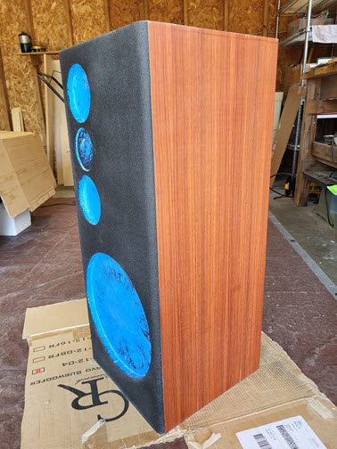

I was able to get the veneer started. Quite a bit of work to go.
I finished two sides and top/bottom for one speaker.
-Rob

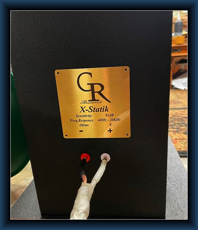

NXSTUDIO-DRUMMER
  • Posts: 259
Re: The Bully Build Begins
« Reply #139 on: 17 Jun 2025, 04:01 am »
To complete the “old school” look, the front needs a plaque that showcases the GR Research logo and a graph of the frequency response. Throw in a couple tone controls and it’s 1977 all over again.
If he is interested, I have the resource to assist him with logo tags, like what I used on my NX-Studio's. Mallard1 and a few others have also added logo tags onto their speakers. Here are a couple logo tag's used on GR-RESEARCH speakers.
