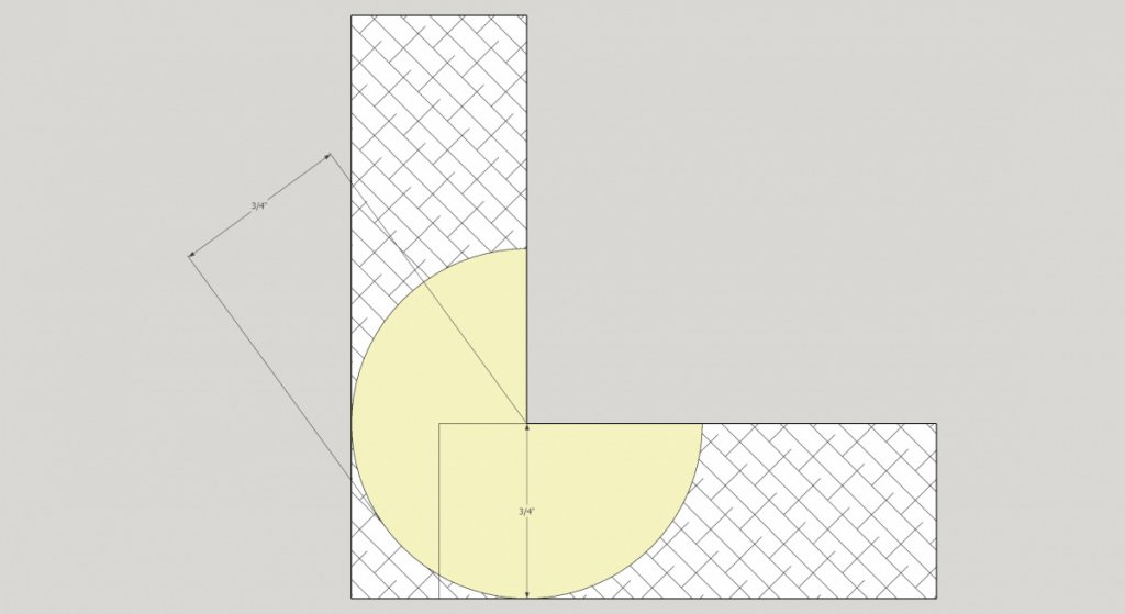

I decided not to veneer the front for a couple of reasons. Through research, I have found that a 3/4" roundover or more is required to smoothly go over the curve without breaking the veneer. If you go to a 3/4" roundover or more, Hobbs says that you need to add more stock to the inside of the cabinet to avoid thinning the cabinet too much. In addition, I would need another $200 sheet of veneer where most of it would be cut away for the drivers. It would also lead to a lot of leftover material that I will never use. On top of all of these facts, my very limited woodworking experience comes from high school woodshop almost 45 years ago. Haven't done any woodworking since.
I feel like it is more cost effective to DuraTex the front. I have seen a few speakers that are black in front and veneered everywhere else and they look pretty cool. 🤷‍♂️
Just to clarify, I have successfully veneered 1/2" radius as have many others. This assumes that one is using paper backed veneer and grain is same orientation as radius. With a 1 1/2" thick baffle, a radius of 1 1/2" could be applied without compromising cabinet thickness through the corner. Driver frame intersection could be a concern though. This came up in X-LS discussion, so I drew this to illustrate.
