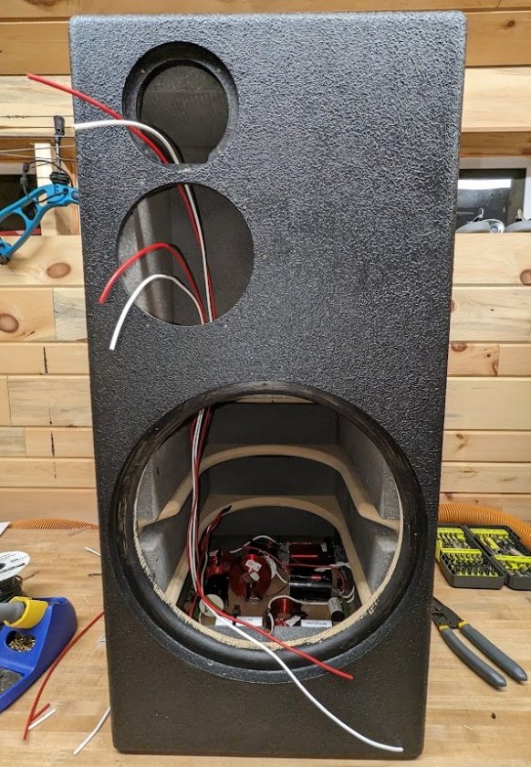

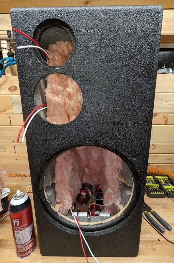

Did you put the back on before adding insulation?
I built the entire speaker minus the front, I then added the norez, then added the crossovers in the base of the cabinets, then wired them all up, then added pink fiberglass insulation batting on top of the norez. Then I glued the front baffles on with the wires hanging out the front.
