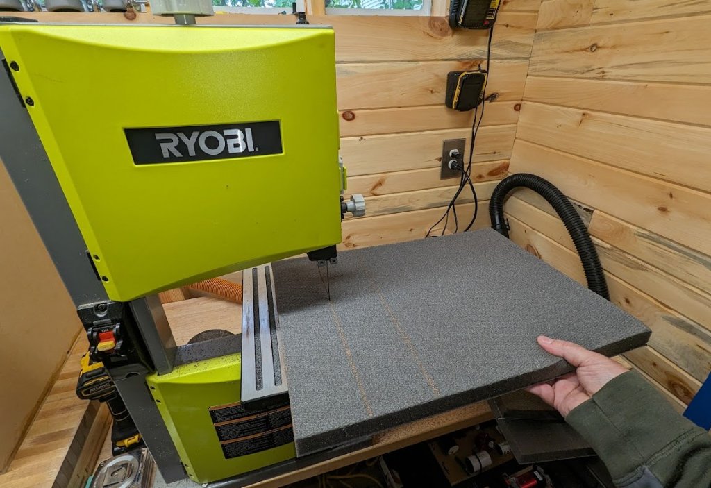

Table saw for straight cuts and bandsaw for radii worked well for me.

I use my band saw, it worked great.

 I will tell you that the the old NoRez damping layer was somewhat abrasive so dulled my steel bandsaw blade fairly rapidly when compared to wood. Carbide tipped tablesaw blade seemed unaffected although, theoretically, it would accelerate wear. I've no experience with latest version but am curious.
I like the bandsaw for all the versatility if offers and just assume it's going to cost me a blade. Only thing I might suggest for tablesaw is make sure your fence is parallel to the blade, but that goes for all materials. Also, dull blades of any type are a nuisance and possibly dangerous.

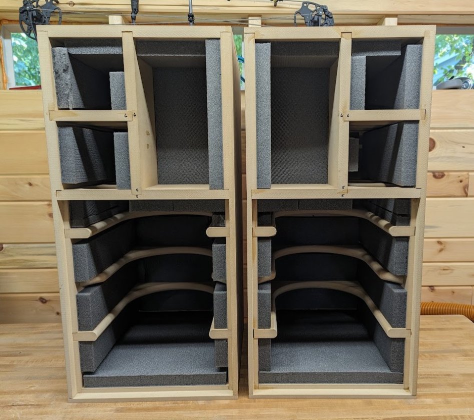

Vince in TX
  • Posts: 394
Re: Cutting No-Rez
« Reply #19 on: 20 Mar 2025, 07:25 pm »
Table saw blade moves fast and heats up the material, never tried. Does it leave gunk on the blade? Any gooey mess? I don't want to mess my borrowed table saw.
Thanks!
This was actually my initial thought when cutting for my Double Troubles, so I didn't break out my table saw until I saw someone else try it, and it looked great.  But, of course, having zero experience with cutting no-Rez at the time, I made the mistake and started with the backing, which was quick to dull utility knife blades, and you can easily see the results of a dull blade on the back of them where I used the not-so-perfect-edged pieces.   I went through a few blades cutting this stuff.
