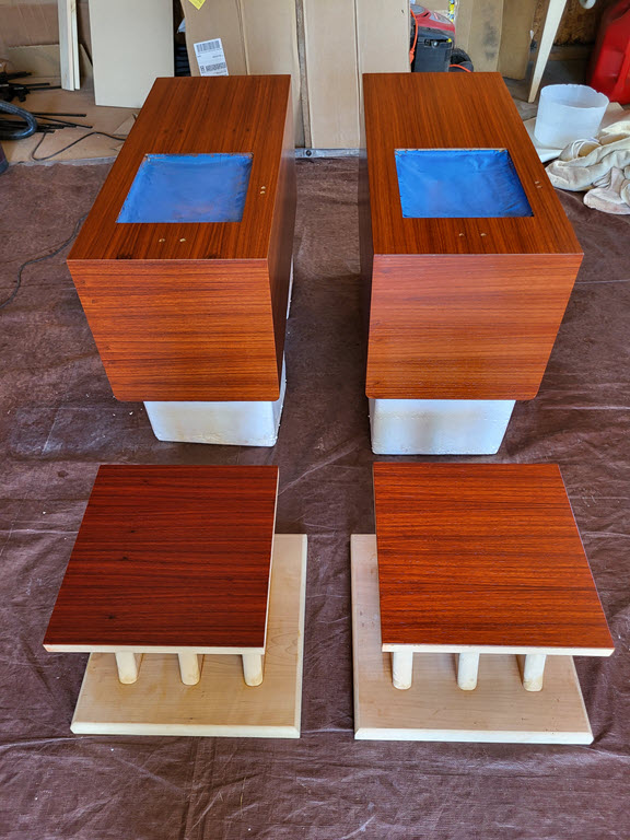

robwm
  • Posts: 170
Re: Classic Stands - Bully
« Reply #16 on: 17 Jul 2025, 07:07 pm »
This is where I'm at now. Since finding out that Duratex doesn't cover wood filler well, I decided to primer the stands before applying Duratex to play it safe. The top of the stands are veneered with Padauk and have 4 coats of oil-based polyurethane.

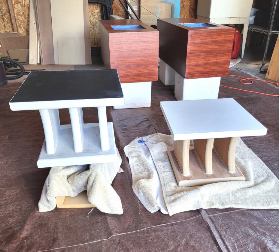

  • Posts: 170
« Reply #17 on: 18 Jul 2025, 04:34 pm »
I have been applying thin coats of Duratex with a smooth foam roller on these. The left has 4 coats, and the right has 2 coats.

  • Posts: 170
« Reply #18 on: 4 Aug 2025, 02:23 pm »
Almost done. I still need to touch up where the white primer is showing and then wax the tops.
