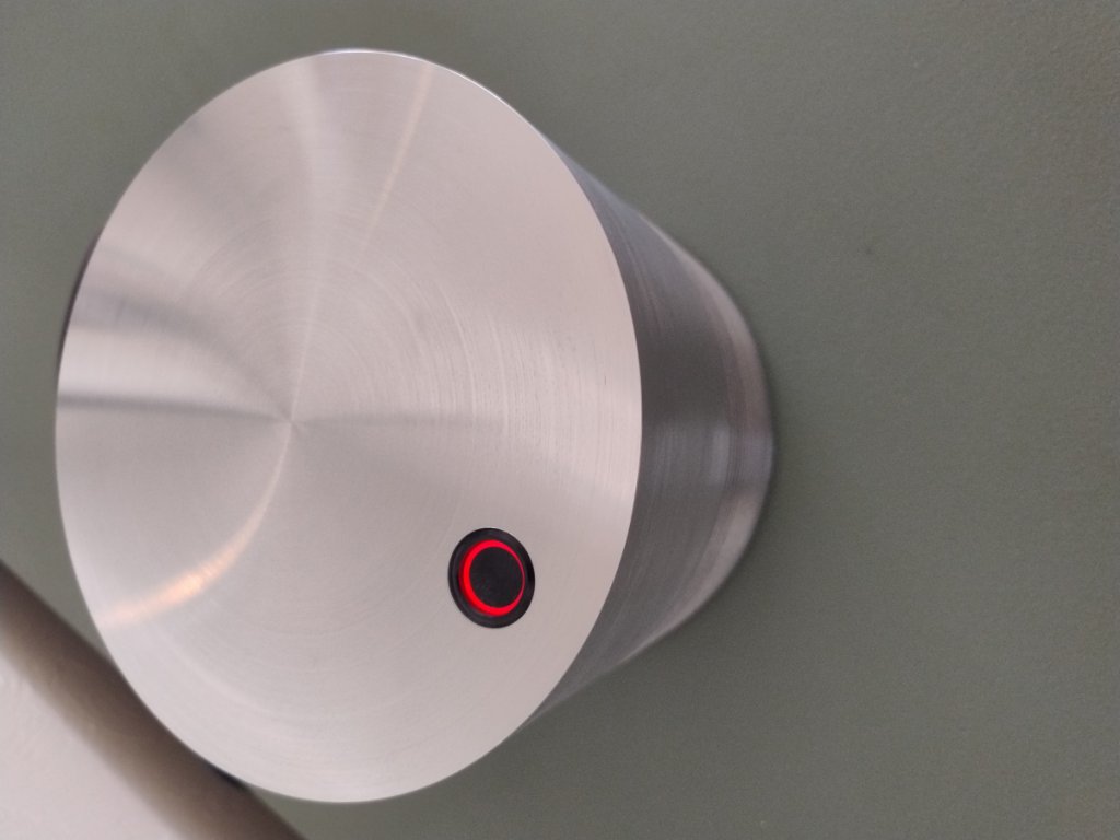

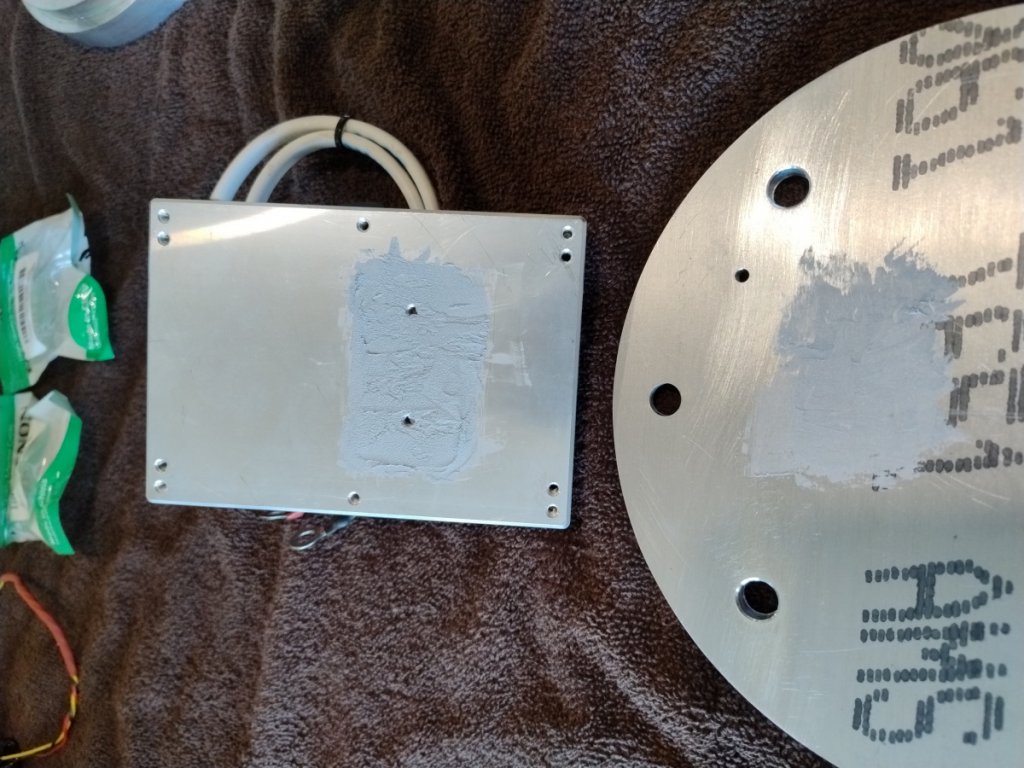

Started building another All-Billet 6061 case for the XRK Audio 3255-PFFB pcb with an integrated power supply...
Added integral heat dissipation fins/ribs near the heat spreader plate this time. 19mm push button LED switch countersunk on this unit as well...

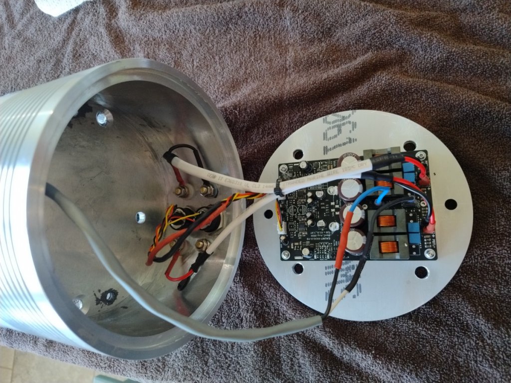

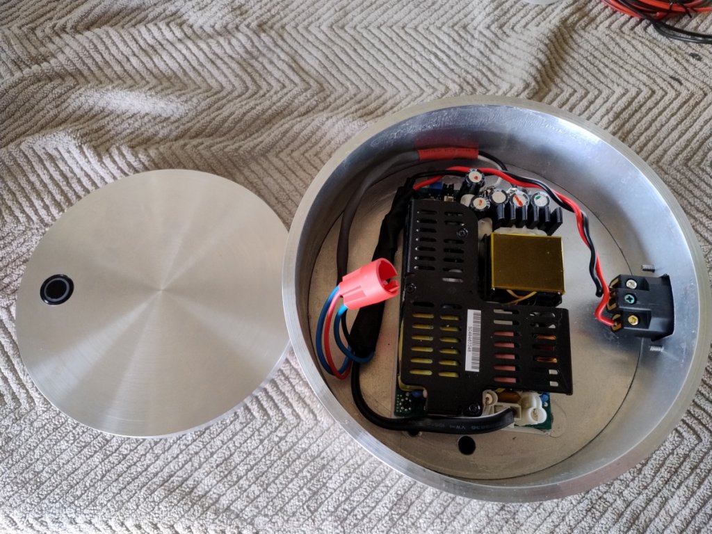

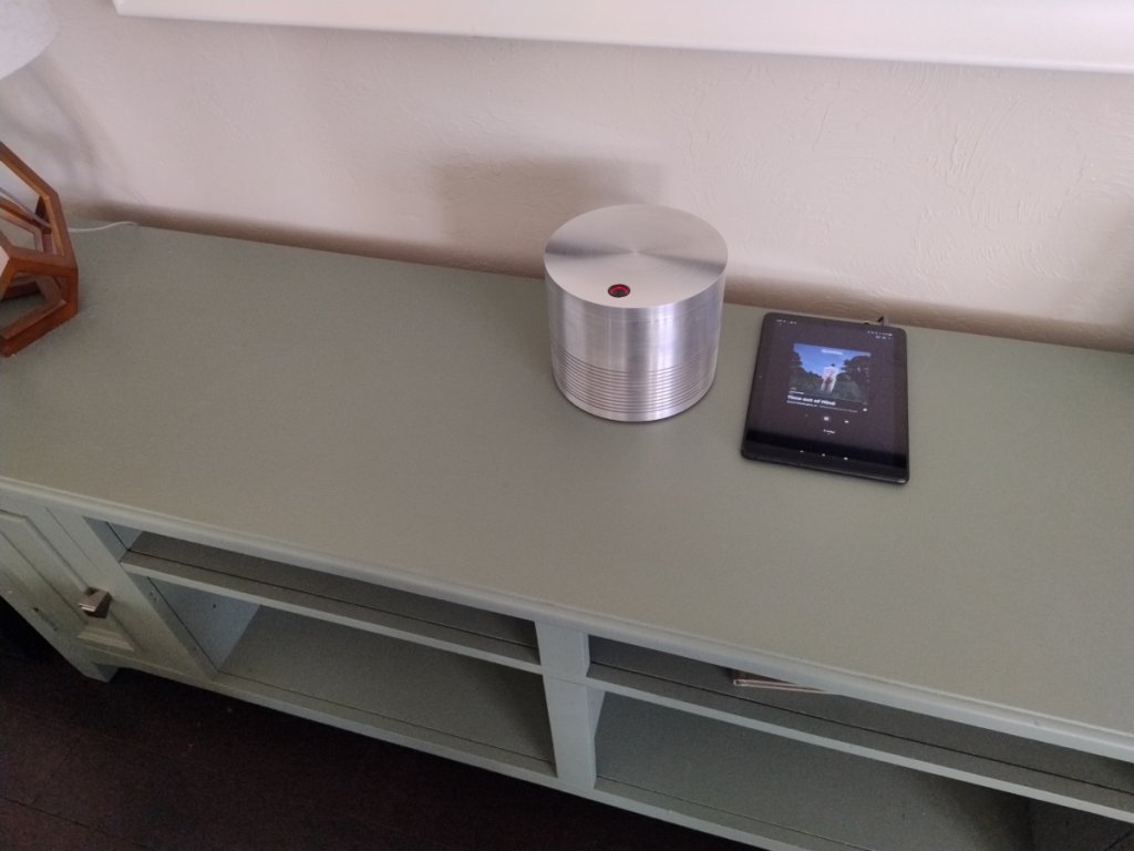

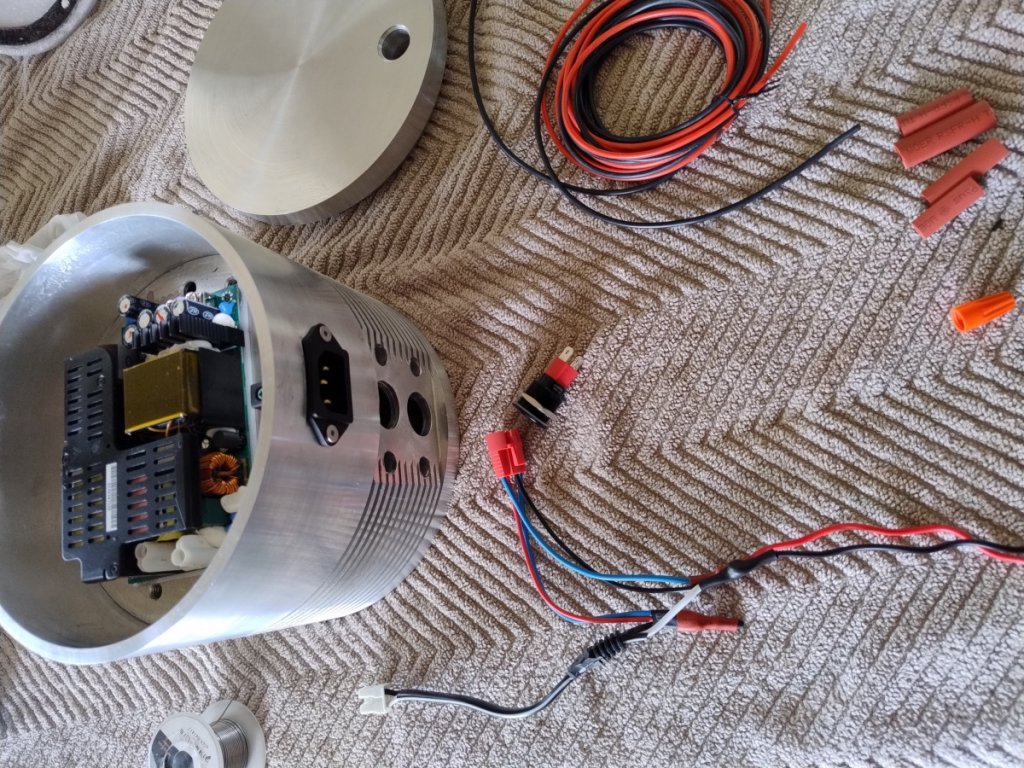

Had to graft in another 3E Audio 3255-PFFB (XRK populated PCB not yet avail.)
The integrated Meanwell LOP 600-48 is dead quiet...

Thanks again. I prefer the all-billet look, but I can experiment on the case by just removing the inputs and speaker terminals. I used a 0.110 carbide insert spaced 0.125" for vane strength. It's all 100% 6061-T6 alloy and tough as nails.
