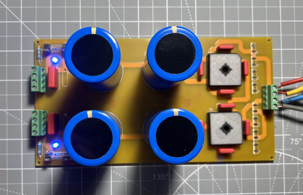

With the new PS supply board the main board is being fed now by 70 amps instead of 35 amps bridge rectifiers.  Think of each mono being mono'd out twice in the PS.....and yes,  each mono has a total of 3 boards !!!!!!!!!
- Ultra Linear 70A Power Supply.
- Use of Two Vishay 35A each Glass Passivated Single-Phase Bridge Rectifier.
- High Surge Current Capability with Low Thermal Resistance.
- Two Fully Independent (35 amps)Rails for Positive and Negative Voltages to the Complementary Toshiba Output Transistors. (.These provides incredible detail to inner phase shift on music recordings)
-  Double copper molding on the PCB Circuit Board for high current application.

Also,  I want to thank Alex G.  as the power supply supply board is actually his design that I incorporate...makes a nice, nice upgrade and iit is an integral part of the sound of the Meilenstein amps.....

Klaus, thanks for your kind words Man…The Statements are just that, a Satetemnt in sound and luxury playing… I have attached a pic of a new PS board just build and under test waiting to be incorporated in the amps!
