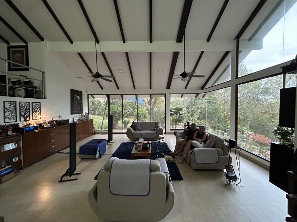

I don’t ha a a dedicated room. My living room is 23 x 20 feet. Always hear max 85 db in symphonies and orchestral works and 80 dB max in jazz. Also hear pop and rock but max 85
mr_bill
Re: MAGNEPAN 1.7i AND MCINTOSH MC312
« Reply #3 on: 21 Feb 2025, 05:00 pm »
You have a beautiful living room!

Not sure if your photo is distorted, but looks like speakers are very far apart and thats alot of glass for reflection. How is the soundstage and echo with that set up? Just curious.

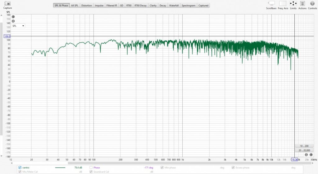

machsw
  • Posts: 16
« Reply #11 on: 11 Mar 2025, 08:08 pm »
Hi,
1. I just bought a pair of mono odyssey stratos extreme fron a guy in Ontario
2. Soundstage is faboluous, open, and despite all the glass in my living room; the frequency response is almost flat from the point of hearing and have an RT of 45
I think it is because they are dipoles.

Good for you with room eq. My system didnt do well in my 22x32x 16 peak room with many windows and hardwood floor. Much better in 20x30x8 room with minimal and draped glass.
