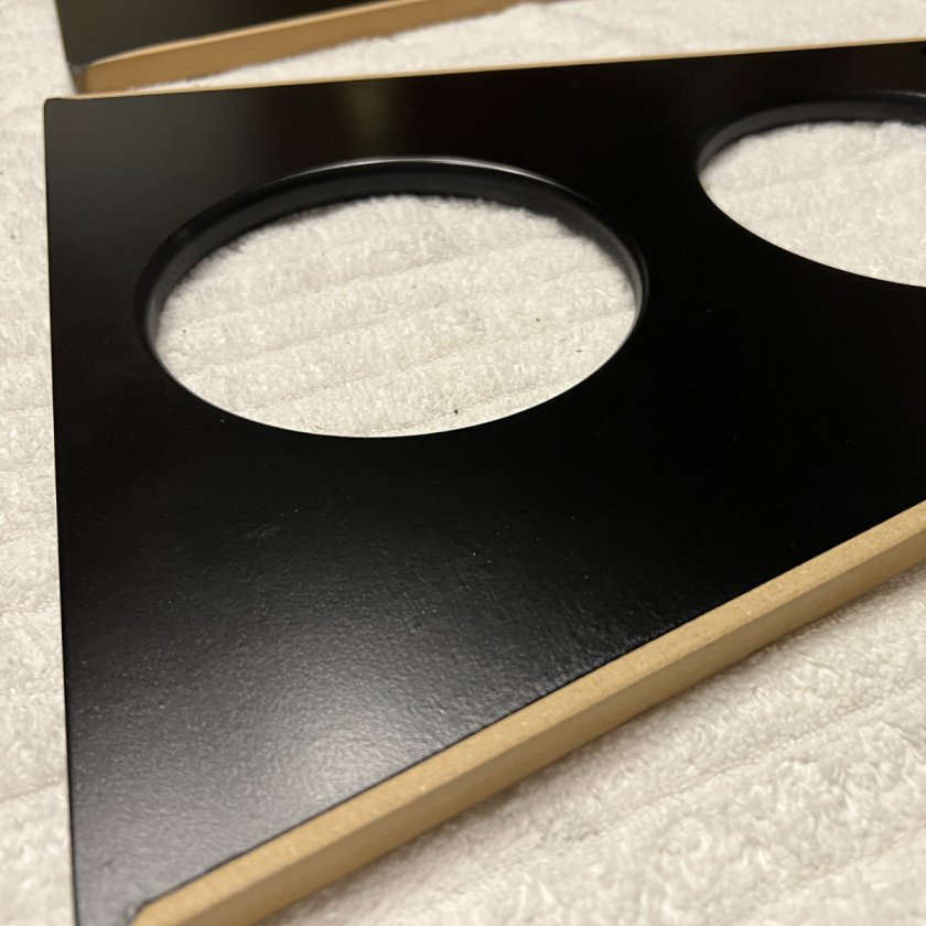

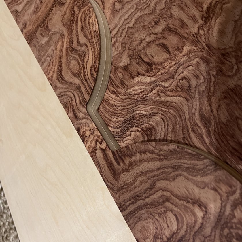

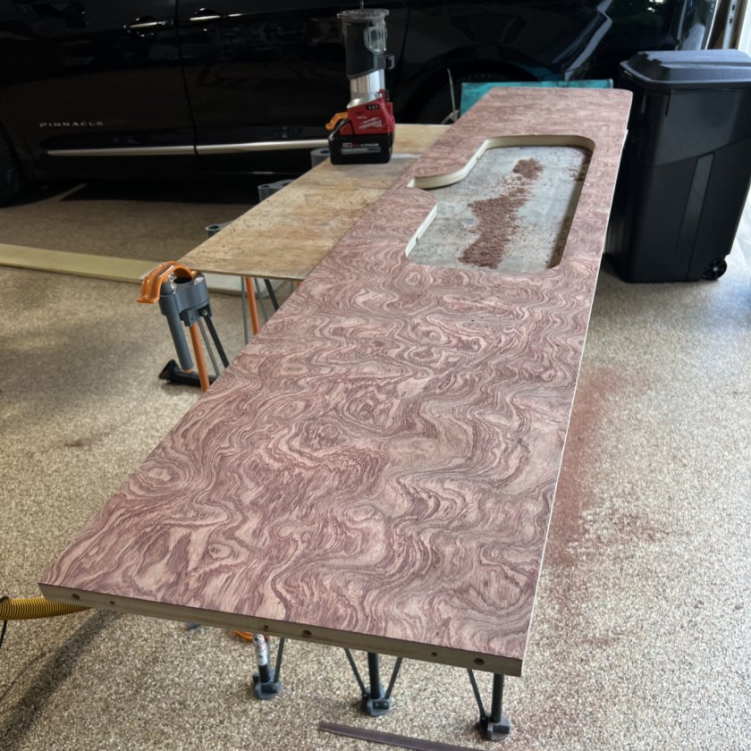

Last images I posted were of the veneer applied to the speaker sides.  This time, I've got them routed out!
Here's a closeup of the cutout for open side next to the tweeter...to run your finger along the edge, you wouldn't know the veneer wasn't originally a part of the MDF!  I used a Milwaukee trim router with a spiral down flush trim bit. I think I'd mentioned previously that I'm using the Heat-Lock glue from veneersupplies.com and that stuff is absolutely amazing.

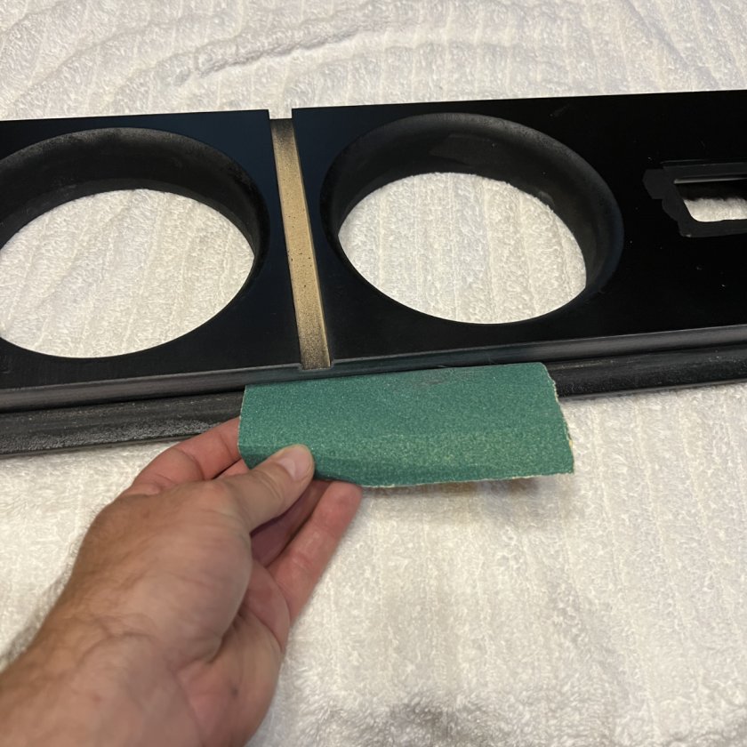

After I got done with that, I realized I still had a little bit of sanding to do.  Using 80 grit sandpaper, I "gently" sanded the back of the MDF where the NoRez will be installed, and I attempted to sand off a decent amount of the spray paint on the back beveled parts of the baffle that will be glued to the sides.

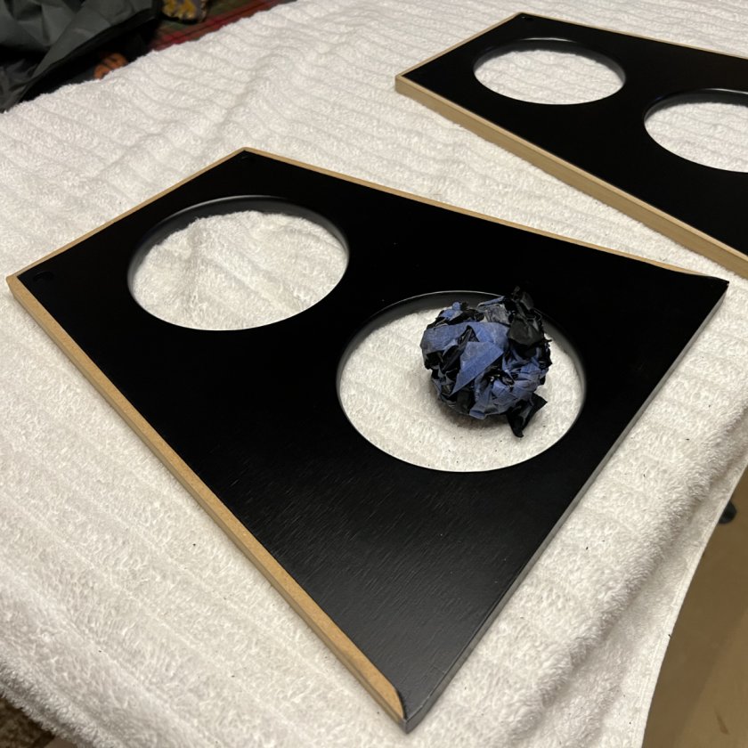

Then, I needed to move on to removing the masking tape I put on all the bracing I painted to ensure there would be good surfaces for the wood glue to adhere to when it was all installed.  Notice that I masked all he edges EXCEPT the "wide" part of the braces as those will be visible from the back of the speaker.
Here's a couple of them after I removed the painters tape - the tape came off pretty easily even though it was a bit tedious.  I just made sure I pulled away from the paint and not down towards it, just in case the paint would try to lift off with the tape (anyone who's painted latex paint on a wall and left painters tape on too long will know what I'm talking about).  Fortunately it never felt like it was going to try and lift the spray paint from the MDF.

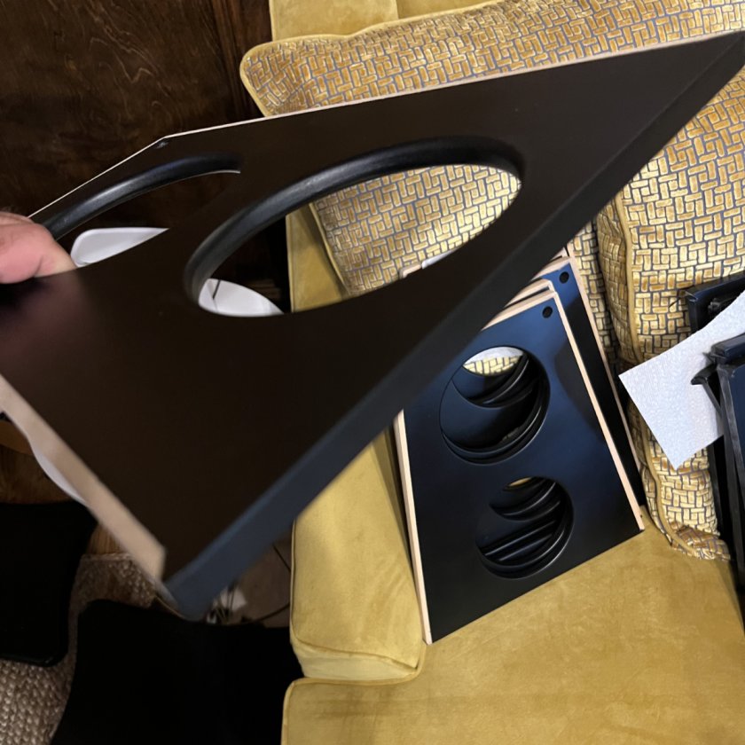

I also wanted to show a closeup of the painted brace - keep in mind that ALL the bracing and anything that wasn't the front of the baffles I used pretty inexpensive Rustoleum paint for the finish.  Considering I didn't spend a crazy amount of time trying to make these perfect, I am very impressed with how they turned out.
A couple of notes on the Rustoleum vs SprayMax and why choose one or the other and if it even matters...
I chose to use the Rustoleum on the parts that would rarely be touched or seen for two reasons
1. Rustoleum was about $6/can whereas the SprayMax was about $30/can (and they both have similar coverage)
2. Rustoleum is not nearly as scratch / scuff resistant as the SprayMax
Because those parts were never going to be touched, I figured putting a cheaper/less durable finish on those was perfectly fine.
What I will say is this - the Rustoleum painted pieces do look very nice.  Considering I didn't spend near as much time prepping the surfaces of the braces compared to the baffles, I am very impressed with the outcome.  That said, the Rustoleum sprays SOOOOO very differently than the SprayMax.  The Rustoleum paints need to be sprayed in very thin layers using very fast motions to avoid runs.  When I post the videos of spraying with the SprayMax, you'll see I sprayed smoothly - not too fast or too slow and I continued layering until I reached the thickness I desired before moving on.  So there are VERY different techniques to spraying the two paints in order to get the results you'd want.

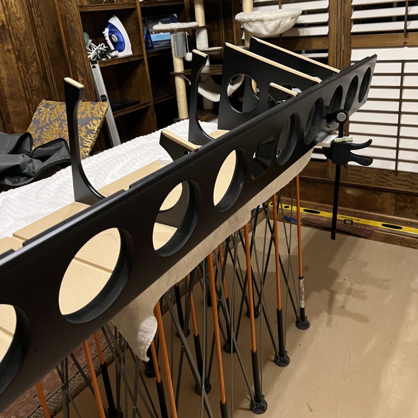

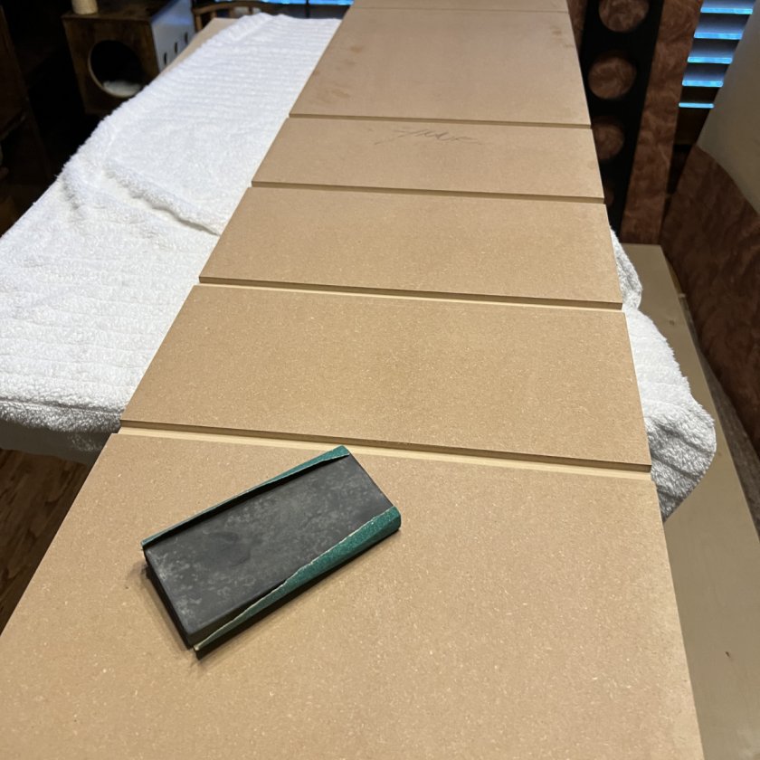

And finally....how about some pictures of what it looks like put together?!
First is a shot where I just started dry-fitting the pieces.  I followed the directions posted by Jay (CaptainHemo) on this thread - if you follow those directions to a T, it's nearly impossible to mess up...
https://www.audiocircle.com/index.php?topic=169138.msg1792762#msg1792762
I used some paper towels on the veneer surface to keep the clamp from marring the surface up, and I just put three of those on the baffle-to-side to keep things in place.
After that, I just continued to drop pieces in place, tap things around to where the BACK of the braces lined up smoothly with the back of the side dados, and then I dropped the other side of the speaker on top and just tapped it into place.  The fit of everything is pretty amazing.  It all fits together perfectly/snuggly!  So here's a shot of it all dry fit together!

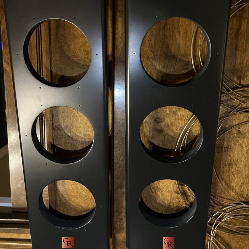

Your Extremes are turning out very nice! As far as tag logo's, just let me know if your interested, I'll be glad to provide the information to assist you with them.
For a basic visualization, I added the logo's on one of your existing photo's. A possible location could be at the bottom of your speakers to ad  the GR-Research Tag Logo. Granted, the scale you prefer is up to you design wise.

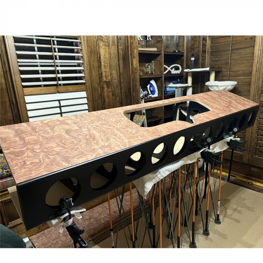

I’ve now assembled (glued/clamped) both speakers!
Here’s the first speaker (the left one).  Things were going well….except, just don’t make the mistake I did and think that you’re doing good by taping / masking off the separate sections during glue-up.  The problem is if you get ANY tape stuck in the glue, it’s REALLY difficult to get out.  Another thing that the tape did was pull up some of the fibers from my veneer   :x
Here’s some photos after I took all the clamps off and it was standing on its own!
One really bad thing that happened as I was trying to extract the pieces of painters tape that got stuck inbetween the baffle and the side is I accidentally scratched the baffle (with a knife) - yeah, I know I should have known better…sooooooooo frustrated about that.  I’m currently trying several ways to touch it up.  I got it not looking terrible by using some touch up paint for a car, however the paint is too glossy.  I tried to tame it down with some eggshell clear, but it doesn’t tone it down enough.  I think the right move is to get some flat paint and then put a touch up of clear over it.  I’ll update once I’ve found the right pattern.  Again, so frustrated I made that mistake.
So, to take a break from being irritated by my bone-headed mistake, I decided to put the right speaker together.  I did things a little different this time because I learned a lot on the first one.
First - NO TAPE
Second - rather than trying to glue everything up in one shot, this time I glued the front baffle to the solid side (the side without the cutout) - then let that dry over night
- Also, this time around, I used four 24” clamps to pull the front baffles as tight to the side as possible - so clamped from the front of the baffles to the back edge of the side - I tried to space these down the speakers to apply that pressure from top to bottom as best as possible
- I also put clamps inside the driver holes and applied pressure from the side into the edge of the baffle to keep things nice and tight
This approach was way better than what I did on the first speaker where I felt like I was rushed to try and get everything done and clamped up.  This approach let me ensure the baffle was very secure to the solid side before proceeding with the bracing and the side with the cutout.
I apparently forgot to take a picture of this (but I have video)…
So, where I have photos is where I had already clamped the entire thing together after standing it up.  BTW - the tips that Jay provide on attaching the foot, standing it up and then apply strap clamps is money.  You COULD do a very good job clamping everything together with standard pistol clamps, but you’d need probably 8 or more 24” clamps to apply enough pressure in enough spots to make it work well, plus you’d still need another 10 or more 6”-12” clamps.  With a speaker this big, the more clamps the better.  In reality, the strap clamps are best because it really does apply pressure all the way around the enclosure which is the best possible scenario.
You’ll notice on the front of the baffle I’m not using any of the strap clamp “corner” plastic pieces because I didn’t want to dent up or mar up the front of the speaker.
On the back of the speaker though, I did use those corner plastic pieces to pull everything snug together.  Works really well with the strap clamps.  Also, worth noting - on the second speaker, I used the pistol grip clamps and the cheapo Harbor Freight strap clamps - I think they’re like $6/each.  Once you learn how to use them effectively, they are excellent for this particular task.  I took some video to show the easiest way to use them on this.
