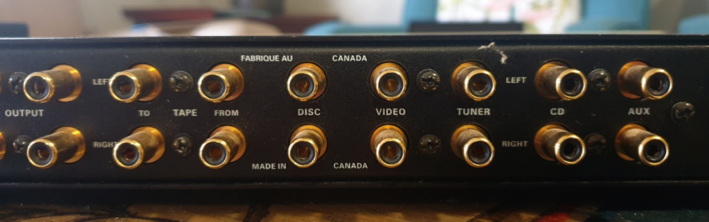

This is probably an elementary question so please only smirk quietly to yourselves, but I have just acquired a BHA-1 and cannot get it to produce a note when connected to my BP-25. I have RCA leads. What are the correct connections to make on each and if necessary is there a benediction I should  recite before or after doing so.

With RCA cables go from the BP25s " Tape To" to the RCA inputs on the BHA1 and make sure the front toggle is set to "RCA" on the BHA1.

Thank you sir!
I thought I had tried that and failed,but now it works like a charm.
