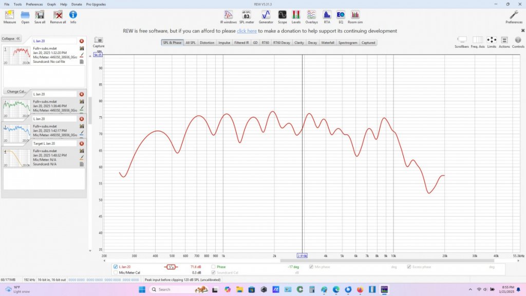

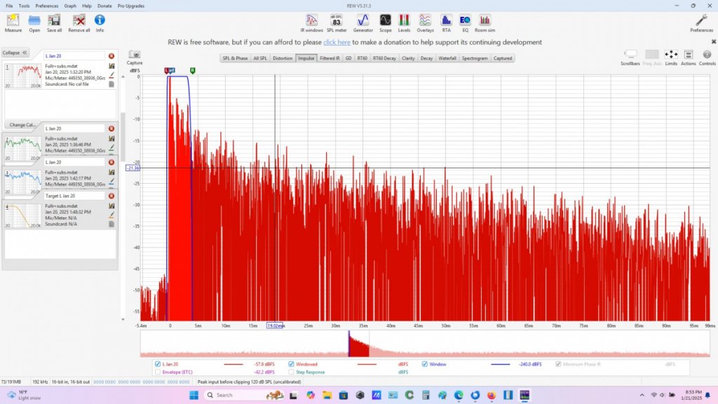

No mater where you put the microphone, you are still taking an room response measurement unless REW will allow you to take a measurement using a gated time window that will omit any room reflections.

« Reply #4 on: 22 Jan 2025, 01:59 am »
Room EQ Wizard can make gated time measurements for response measurements.  Just like CLIO, setting the time window and seeing the resulting frequency response.
