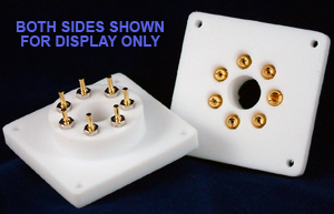

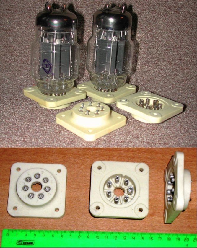

First let me say that Ceramic Tube Sockets are the worse sockets one can use,
its sound are awful, they are very microphonic, they transmit vibration from the
transformers to the tubes as a bell, the ceramic is a hard material that does not
react with heat like Teflon. Its vantage are they are cheap and last until the rivets
on the ceramic contacts loosen.
I get mine years ago from Jake in Italy.
https://www.jakeband.it/contatti-contact.html
You must ask to Septar Sockets usually used in 6C33 tubes.
At those times Septar Teflon sockets was available only from some
audiophile sources as PCX, Yamamoto, Good Component etc...
Today Teflon Sockets are much more rare, but you could try here:
https://www.bartola.co.uk/valves/2016/03/20/teflon-sockets/

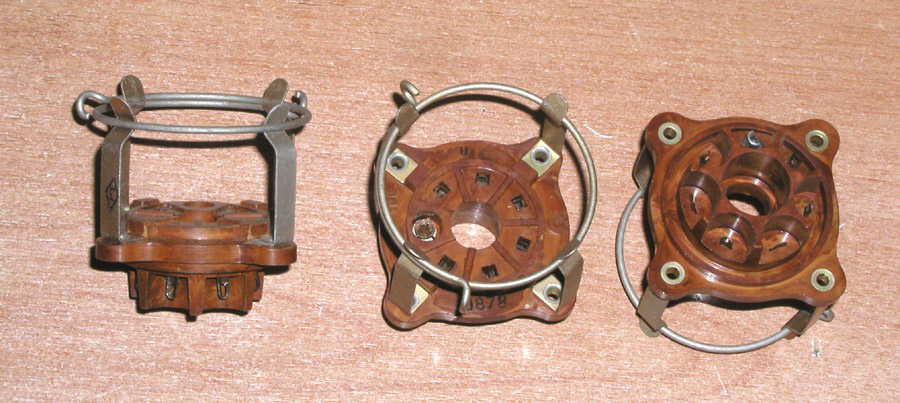

As a second alternative there is the Russian Rubberized Bakelite
Model PL3-1pD37 made by Silbelkom.
They are cheap, small and will last a century.
I happen to have some spare if GSTube.com dont have any to sell you.
https://www.gstube.com/catalog/rsh3-0/
« Last Edit: 9 Dec 2025, 01:37 am by FullRangeMan »

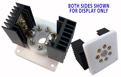

Other miscelaneous Sockets of interest:
PLK7 Collect Ceramic Russian Military Missile Socket for 6C33:
Ceramic Socket for GK71 Pentode:
PCX Teflon Septar for 6C33:
Russian Rubberized Bakelite:
